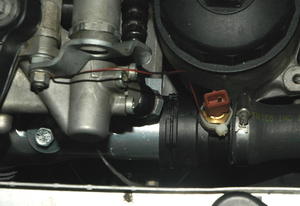

                I had the same problem and put it here.
