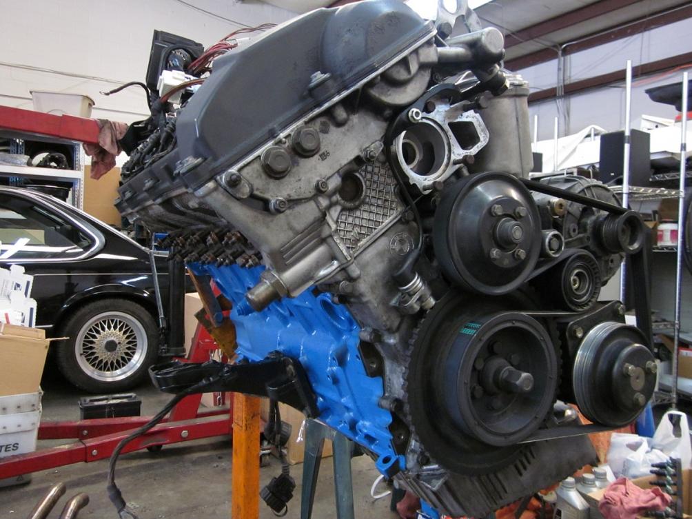

    The project begins. S50/'91 318i & E36 M3 5 lug conversion
    Wish me luck.......

      Yeah, I will be replacing ALOT of stuff during this project. ;)
      Motor is almost ready to go back in. S50 with ZF trans and 3.64 diff. :D

          I'm looking at the picture of your motor with timing my motor in mind.. how the h3ll am I supposed to use a timing light to see that TDC mark with the motor installed?
                  Impossible.
