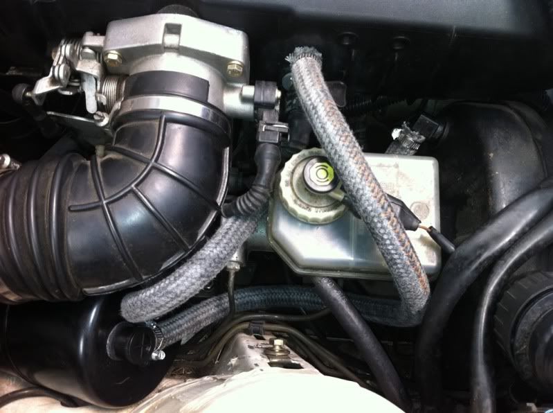

          Sold my swap car early 2010. My dad made me a custom bracket that placed the canister horizontally underneath the master cylinder.
          As far as routing the vacuum lines, it's really easy. The vacuum line that runs between the intake manifold and the booster is basically cut in two, with one end (from the booster) going into one of the canister fittings, and the other one (from the canister to the manifold) goes to the second fitting. Result = double the volume of vacuum, bringing better then factory booster pedal feel and effort! :D

              Originally posted by samiam3356
              Would have like to seen that second vacuum line.
              Not pictured in the for sale ad, is the other fitting that goes in the second hole on top. You run the second vacuum line from that fitting, to the nipple on the intake manifold.
              Here is a pic of how it goes:
              Uploaded with ImageShack.us
