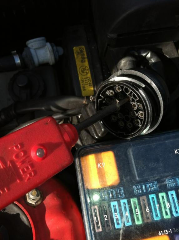

Ok, well I had a look see at my VSS wiring and it seems I am not getting any power from the cluster at all. Below is a picture of me checking pin 14 at the c101 and x20 connection. Also everyone always states that pin 42 on the harness is VSS input which on my NV e36 harnes is blank., so I decided to trace the black/white wire and came back with pin 73 which would make sense, below is a picture of pin 42 and you can see that it is blank on the harness side. So now I have to pull the cluster and see where there is a break in the wiring.Your signature picture has been removed since it contained the Photobucket "upgrade your account" image.

I told you pin 42 is blank, I AINT CRAZYOk, well I had a look see at my VSS wiring and it seems I am not getting any power from the cluster at all. Below is a picture of me checking pin 14 at the c101 and x20 connection. Also everyone always states that pin 42 on the harness is VSS input which on my NV e36 harnes is blank., so I decided to trace the black/white wire and came back with pin 73 which would make sense, below is a picture of pin 42 and you can see that it is blank on the harness side. So now I have to pull the cluster and see where there is a break in the wiring.

No power at pin 14, on the x20 side and no power on the c101 side which means the wire that goes between c3 on the cluster and the c101 there is a break.Your signature picture has been removed since it contained the Photobucket "upgrade your account" image.
