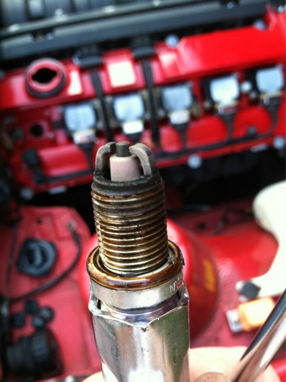

I think not, i replaced my 02 sensor three times. And i have brand new spark plugs and coils which were then tested for resistanceYour signature picture has been removed since it contained the Photobucket "upgrade your account" image.
