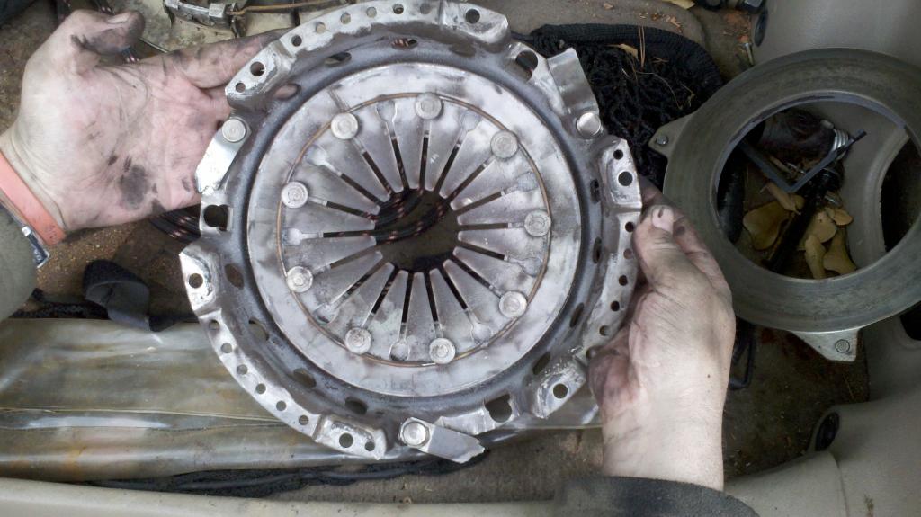

    Note the ninja star-like appearance of the pressure plate where the sheet metal ripped from the three rivets that hold the flywheel contacting surface on (sorry not sure of the technical name of this piece)

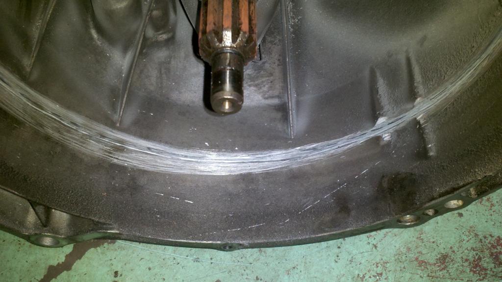

    inside of the bell housing on transmission

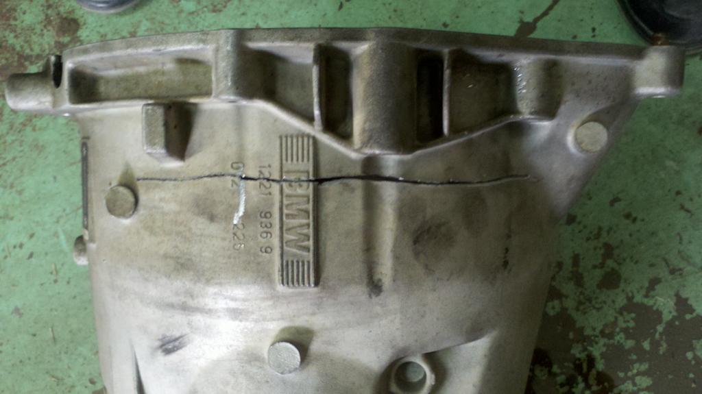

    side of transmission where the pressure plate cut ALL THE WAY THROUGH

    The clutch disk looked perfect, barely worn. The flywheel surface was perfect also, with zero signs of slippage
    Both of my friends who are BMW mechanics said that in 20+ years of work they have neither seen or even heard of this type of failure. Have you guys ever seen anything like that?!
    I think just a few more miles would have sawed it completely in half!! Tranny is at a highly reputable aluminum welder today for a hopefully successful repair of circumferential cut, I will update how this repair and reassembly progresses. Wish me luck lol

          Actually it is not that unusual. Those are the "straps" that people refer to on the pressure plate. More straps = better. I'd look for one with at least 3, probably 4. Alternatively Bimmerworld has a strapless solution that avoids the issue altogether but it isn't a cheap solution.

                  welcome to G260 clutches. Seen this happen too many times.

                    This is what makes the five strap pressure plate from clutch masters worth it.
                    You are lucky you don't have shrapnel embedded in your nuts, thighs and calves. After seeing things like this as well as broken flywheels it isn't hard to justify the cost of a JB wheel over lightened stock, two strap pp and unsprung clutches.
                    What clutch were you using anyways?

                            I had one of my pressure plate straps break after about 100 miles with my S50 swap. It cut a groove in the bellhousing but nothing like what happened to yours. Shiiiit!!! The noise it made was quite alarming!!! I thought that I had broken something in the bottom end of the motor but baffled how it ran so smooth. lol
                            Luckily I didn't have to drive far when it let go since I was still in my neighborhood. It did knock the rod over 3/4 off the slave cylinder, luckily it didn't fall to the bottom. Amazed that I made it as far I did.
                            I replaced with a Clutchmasters stage two set up. Much stickier/better than stock.
