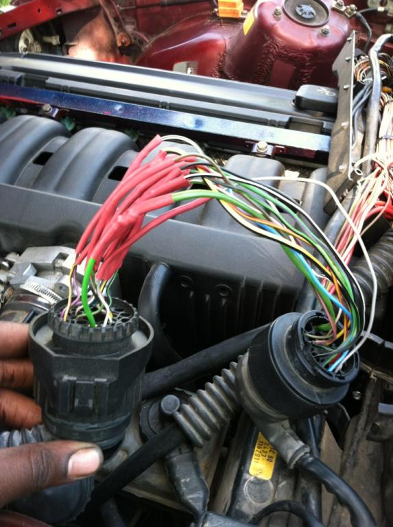

                            there are pins that connect together. you need a male pin to wire on your E36 harness to plug into the E30's C101 connector.

                              this what im looking at, so do i need to remove a pin out of the connector and put different conectors on em? (female&male)?
