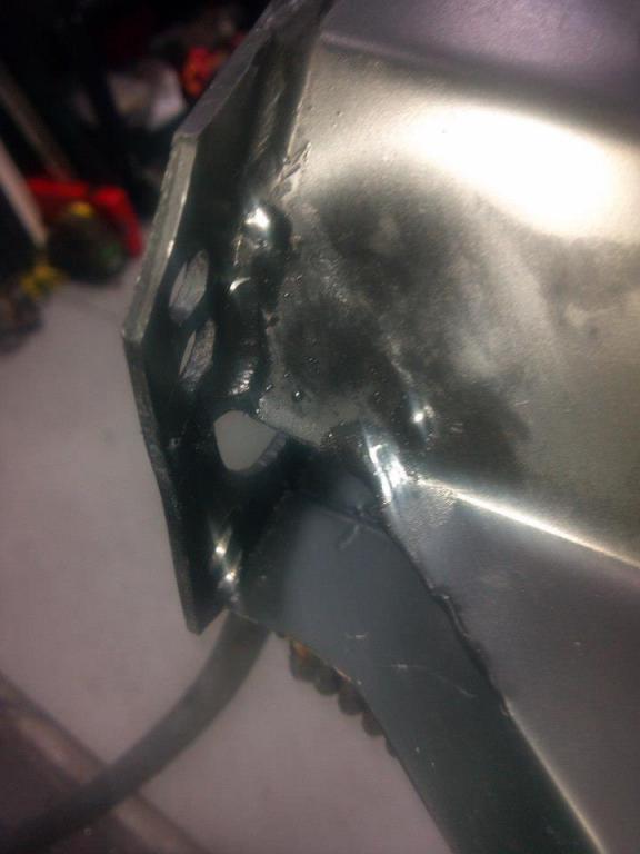

              • bimmer630
                • 1228
                #67

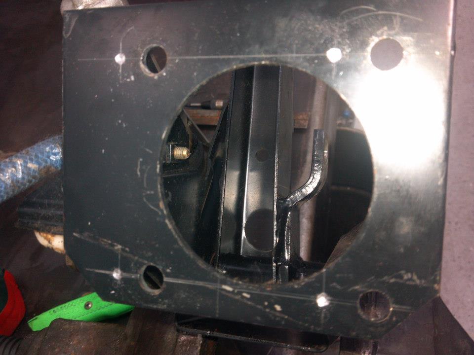

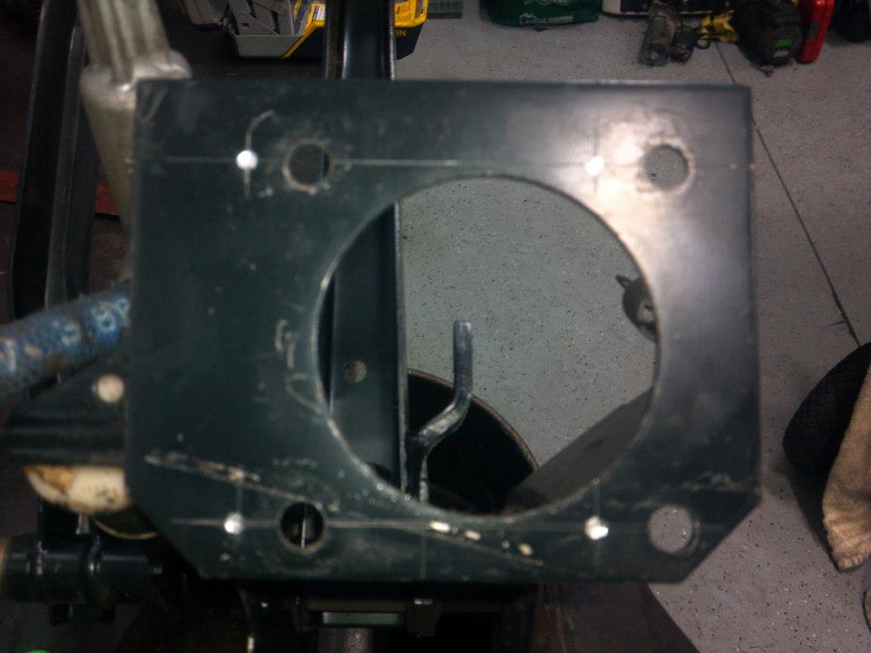

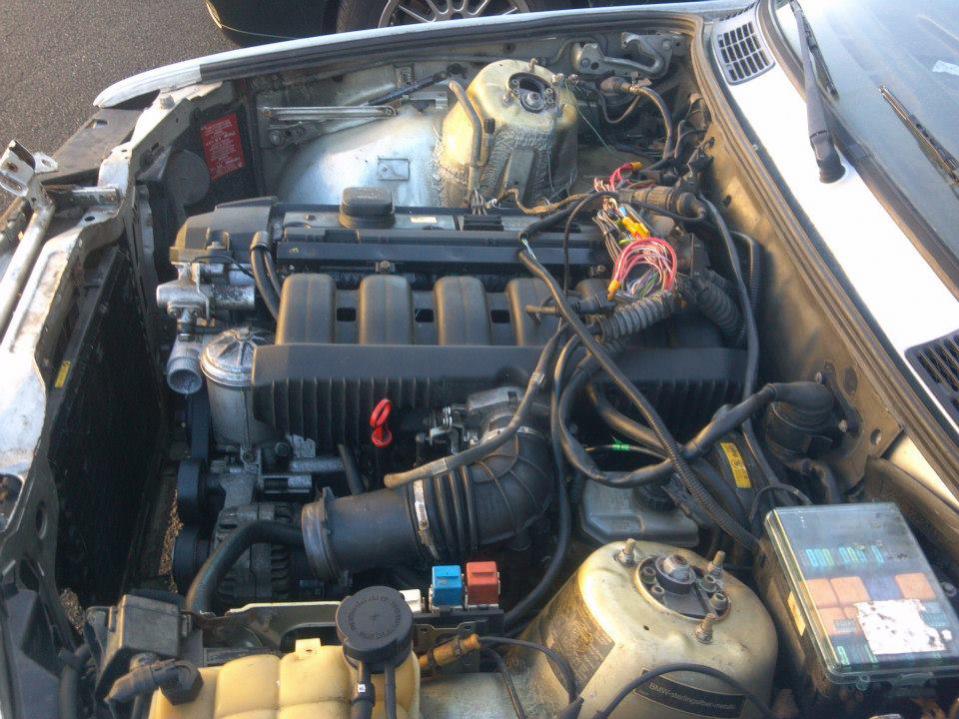

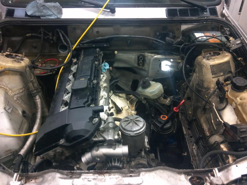

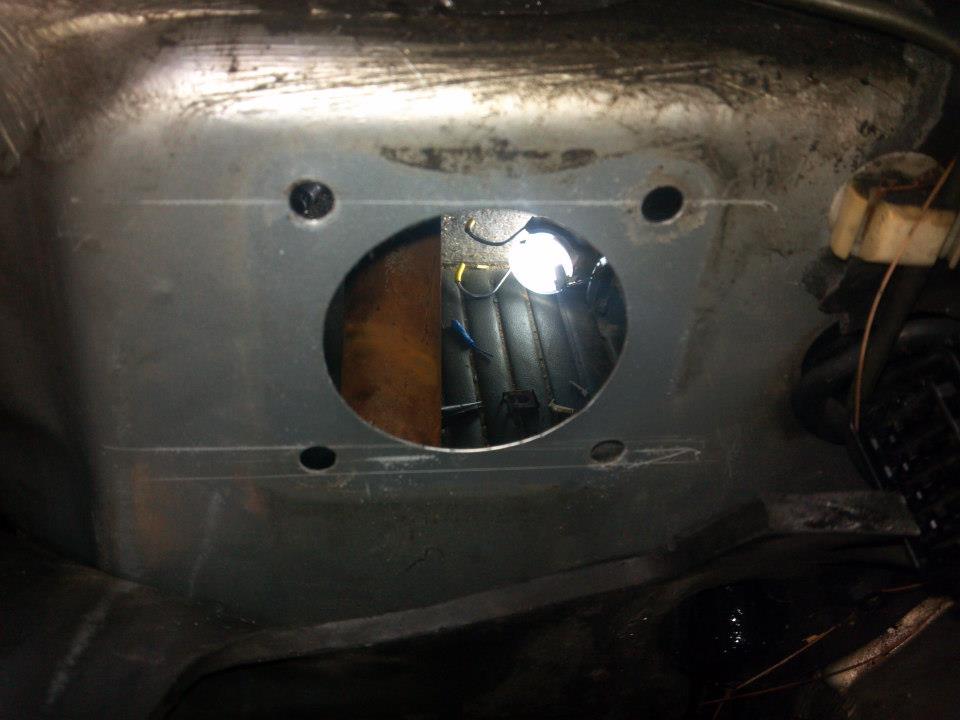

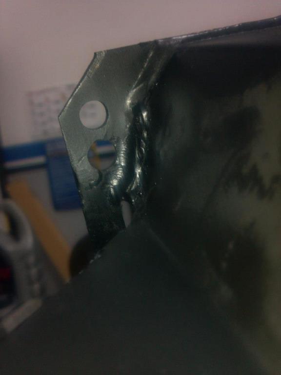

                I may have posted these before on another thread, but its slow at work and I'm bored. This thread seems to have been revived so I figured I'd share pics of how I did mine. Ive been driving it for 3 (?) years now with no issues. AKG swap engine mounts
                • bimmer630
                  • 1228
                  #68
                  more pics.
                  • bimmer630
                    • 1228
                    #69
                    I had a spare booster and clevis rod which I intended on chopping in half like the OP did.. But when it came down to it, I couldnt remember where I stuck the spare booster.. so I just whipped up the clevis piece out of some scrap stock that was laying around. Theres no binding at all.
