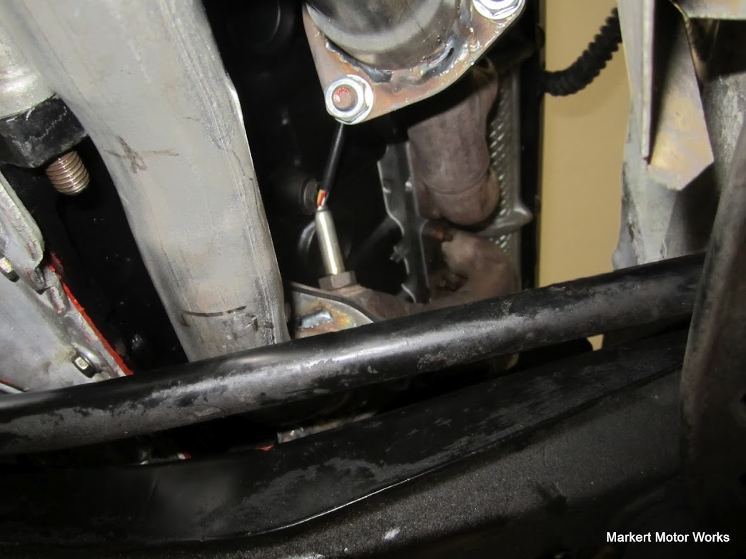

    Snap a pictar for me of the pass strut tower with the mount, pretty please?

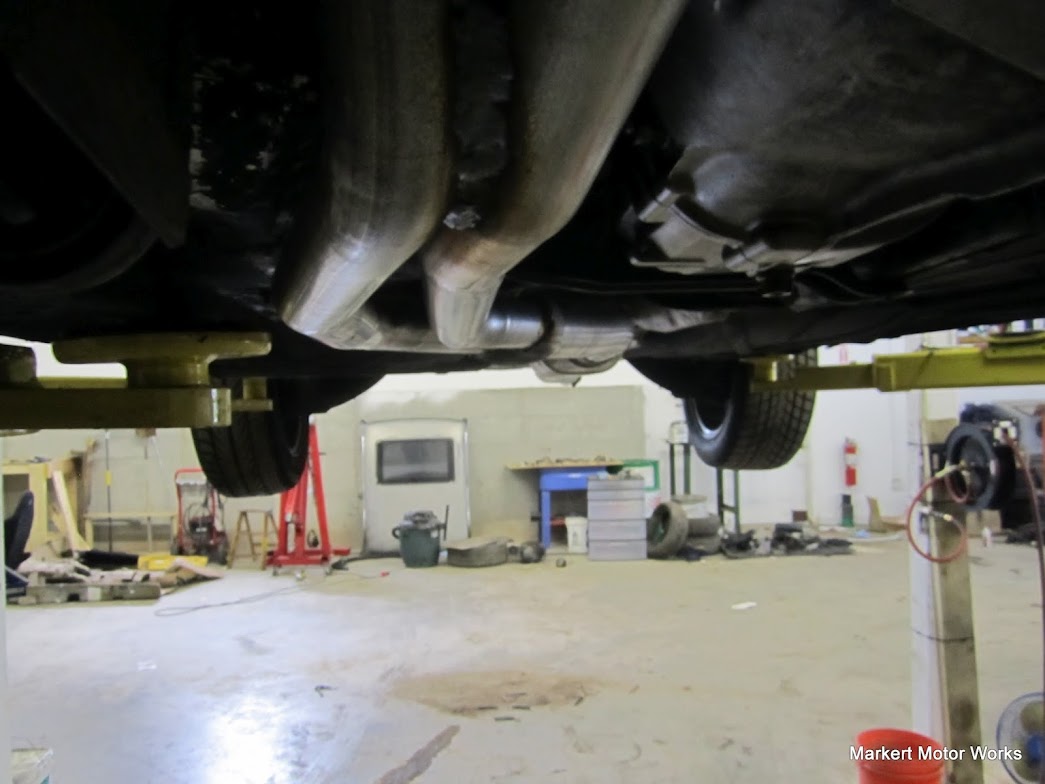

            Oh and exhaust pictars:

                  I've been thinking of putting the s50 from my e30 into my e36 but realized that the crank and block don't have the same pick-up and trigger as the OBD2. I see your trigger wheel is exactly the same as OBD1. Anything special to do there?

                    The Key is the Super Secret OBD2 Euro Crank Sensor :D
                    PN: 12 14 1 703 277
                    Its designed to run of the front crank pulley just like the OBD1 one (although its a completely different sensor) because as you mentioned, no hole in the block for the regular OBD2 one!
