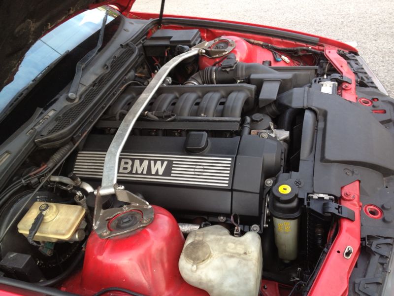

                          m50 3.0L stroker hoping to run OBDII question
                          Hello,
                          I have some questions, if you could help me clarify some things please.
                          I just recently finished my Budget 3.0L stroker that I planned on running on my OBDI e36 325i. No longer have that car so I now plan on installing it on my current OBDII e36 328i.
                          it is running m50 block with no crank position sensor on the block obviously so I bought the Super Secret Euro Crank Position Sensor on the original post.
                          Not sure how it all works together, I'm hoping its a plug and play but I feel that would just be unreal. will it plug in straight into the OBDII Harness with no modifications?
                          Worst case scenario I convert the car to run OBDI but I'd much rather run an OBDII setup.
                          Here are some pics for reference, hopefully it helps understand my question.
                          ^^^^^^Is this where the Super Secret CPS will plug into?
                          Thank You,
                          Any input is appreciated.

                            #43
                            Plug OBD2 sensor into OBD2 harness and go! ;)

                              #44
                              Thank you for quick reply, life saver!
                              That's all? I've been wrecking my brain the whole time I was putting the engine together. My brain kept asking what if it does not work like planned. Then brain overload.
                              So leave these two plugs tucked away somewhere not on the way, and pug in the Secret Sensor to the main harness and good to go?
                              Thank you thank you!
