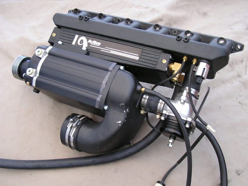

                        90 e30m3 w/ an s52 obd1 conversion-this really changed the car and in my opinion for the better....i'll be saving up as i'll be dropping in a twinscrew supercharger in it.
                        something like this that's already in my e36m3...

                            Originally posted by vr4boy
                            i'm very happy with both of my swaps which i did myself.
                            most rewarding part of the swap is when you see the m/s 50/52 engine sitting in the e30 engine bay and asking yourself-how the hell did it fit in there....then,hear it start for the very first time w/ open headers.
                            then the feeling you have when you take it out for the very first time: makes you smile ear to ear like a kid at a candy store...this is a lil' monster you created!
                            my swaps:
                            91 mtech vert that got an m50 non vanos/5 speed conversion(sold to my nephew-he's even happier...)
                            How much for this kit and tune??? That looks like a really well put together kit...but I wouldn't think any less from active.
