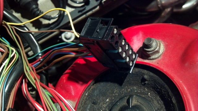

                              Also wanted to add does this plug next to the ECU plug do anything? We assumed it was for the Auto transmission but we didn't know if we needed to put power to any of the wires, it doesn't plug into anything...
