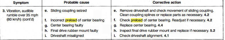

                        OP, if you dont have an e30 bentley manual, get one. It's available as a PDF somewhere around the internet but i'd recommend buying it.
                        I think this is a screenshot of your problem, cause and solution found in the trouble shooting section of the bentley.
                        You may want to talk to your mechanic about 'center support bearing preload'
