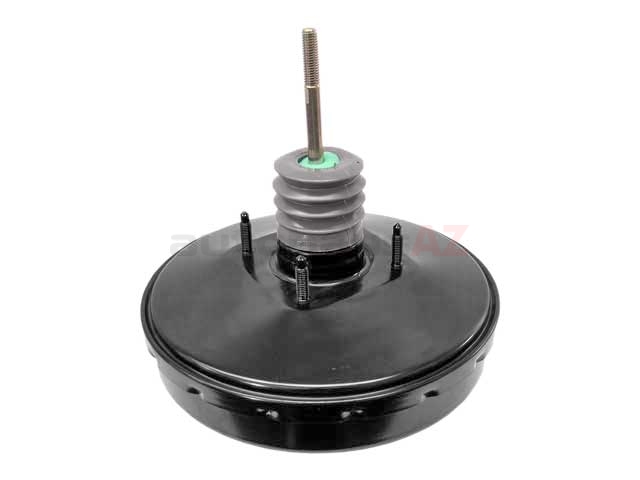

                                Originally posted by FredK
                                You need to shorten and thread the 944 booster input rod, but it is the same thread diameter and pitch as the E30 clevis.
                                Did this any found out that there is one other difference between the e30 and the 944 boosters: The e30 one has a bump out where the booster bolts against the firewall, the 944 is missing that.
                                E30:
                                944
                                The 944 just requires a much closer firewall clearance than the stock e30 one does. Required that I trim away a lot of the firewall insulation (no big deal), and also relocate the brake line heading to the RF wheel (bigger deal). Doesn't really fit all that well, but good enough. If I'd have known about it I would have either gotten a different booster or made a spacer plate. As it is, I can't go the spacer route having already cut off the input rod to the right length.
                                After looking at some 944 images just now, it seems as if they're not all the same. However, mine was just like the one shown.
