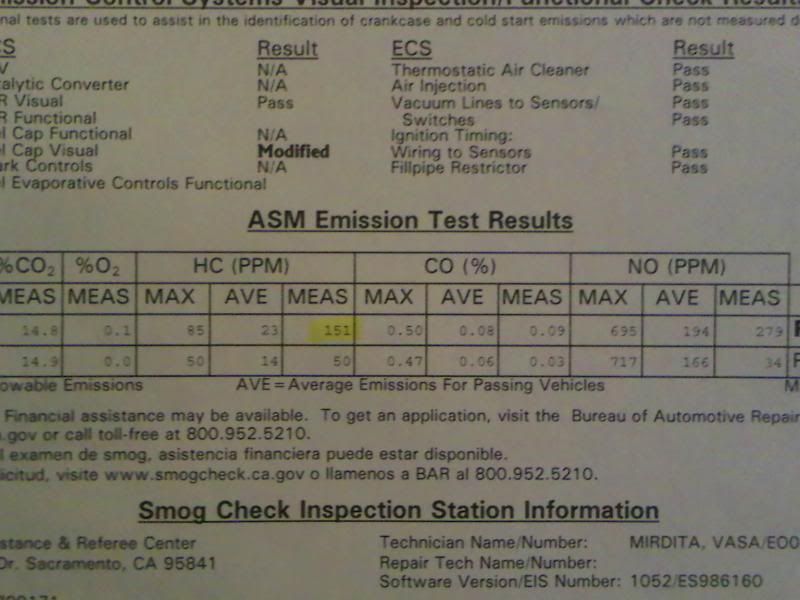

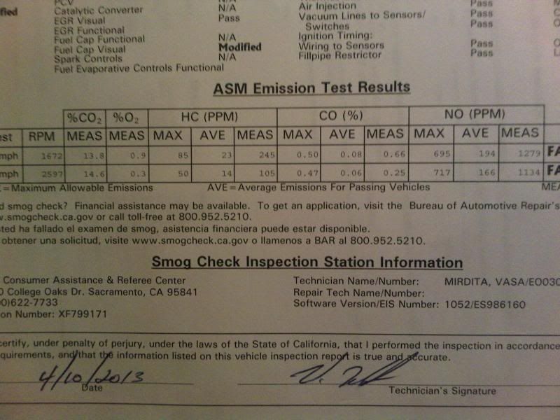

    problem number 1)they want documentation proving that the red label 413 is
    for the motor. also the ref said my ecu was registering that the car was moving at 18mph while sitting still. so what would cause the ecu to do that? can I even get documentation to prove that it is the correct ecu? or will i have to get a silver label and a chip?
    Update:
    I switched to a remanufactured silver label 506, the ref is still saying he cant confirm if its the correct DME... Also that his computer is registering my DME reading 18mph sitting still. so that has me a bit frustrated.
    problem number 2) the ref said that my cat was not for my motor because its a dual inlet and outlet and not individual cats even though its a direct replacement part.. i guess here im just asking if anybody has some used stock ones for sale? that would be awesome.
    Update:
    fixed, i got the new cats he recommended.
    problem number 3) the numbers on smog where terrible. Im now thinking my cat is shot and that had alot to do with it. im going to do air filter, fuel filter and plugs just the basics because i am not sure the last time it was done. probably should have done that first though... do you think a bad cat would do that? if not what else(besides basic tune up stuff that im going to do) could it be?
    Update:
    The numbers were much better (see second picture) this time. im still high on HC. Im wondering if a can of seafoam will do the trick

    I'm in sac also and working on my swap and defenetly will work towrads BARing the car. Also the NO measurements are consistant with bad cats. I had similar numbers on my eta and rhe cat was toast. Put a hew one and smog pass with flying colors. I payed 235 for the cat (single)

        Red 413 is not the stock ecu for a 95 S50. That would be a silver 506 DME. You need two individual cats. The dual in dual out is stock replacement for an M50, not an S50. Looks like you do indeed have a bad cat according to your numbers. Try to get the car BAR'd in a different location. Certain guys are more lenient than others.
