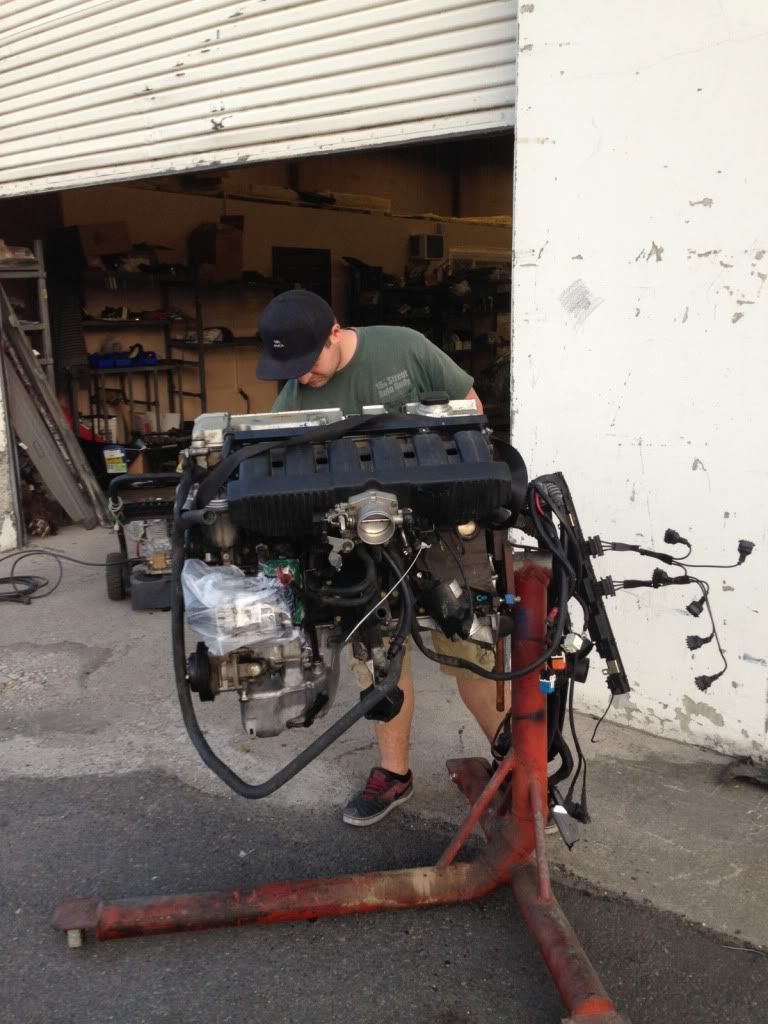

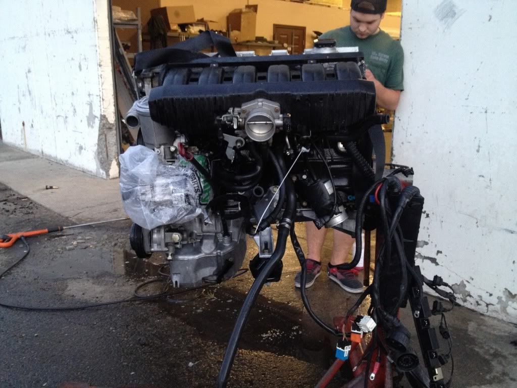

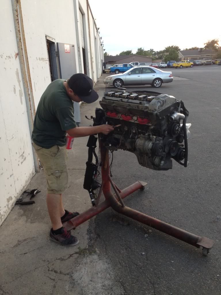

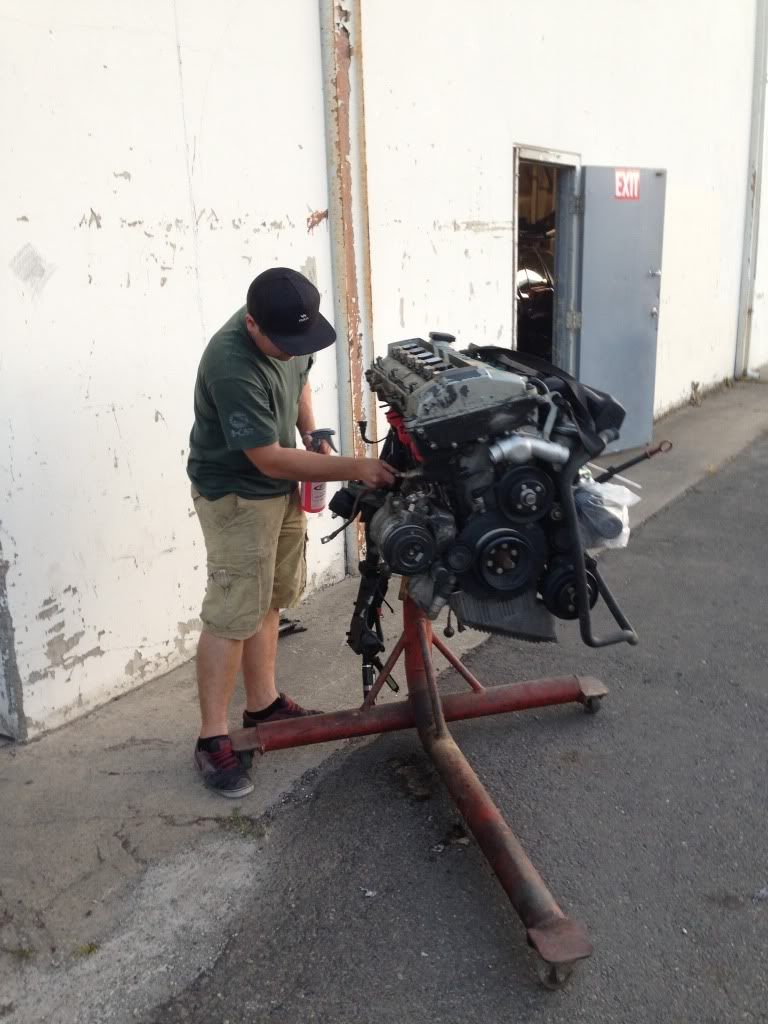

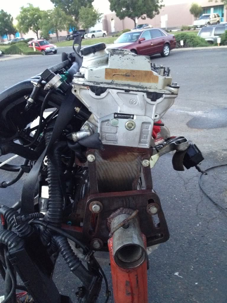

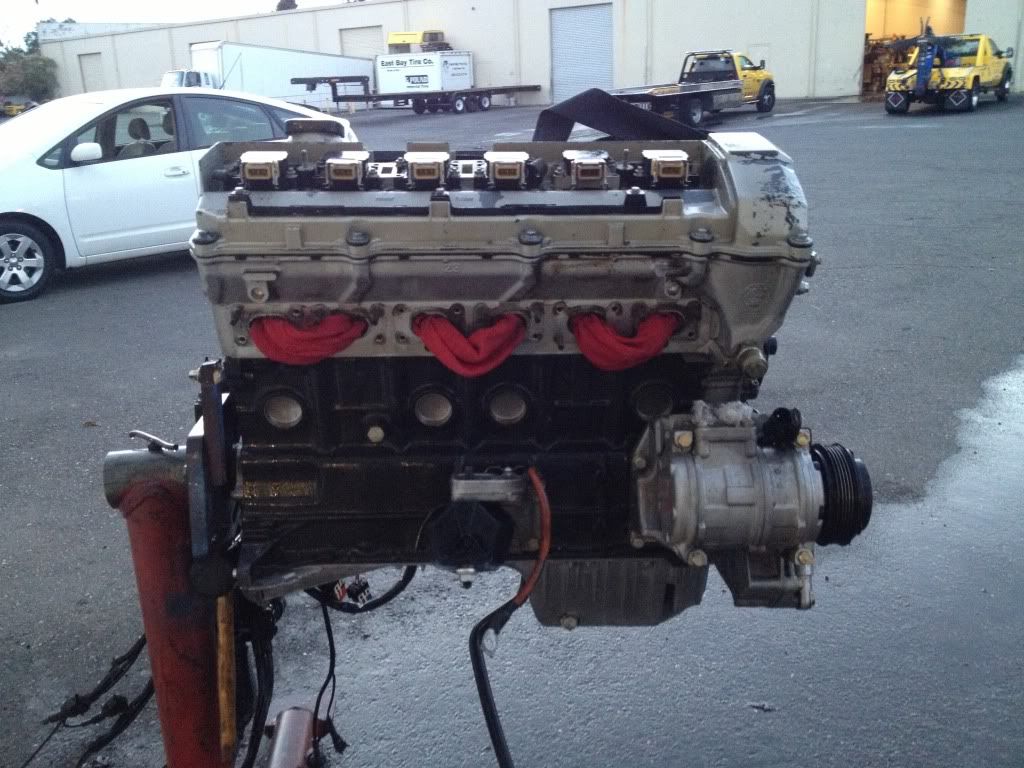

    Thanks to my friend Serge for helping me source some really high strength degreaser to clean the motor.
    What a professional cleaner ;)

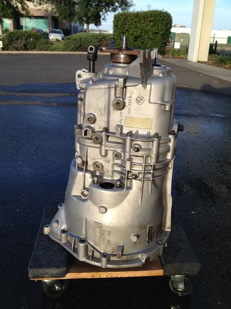

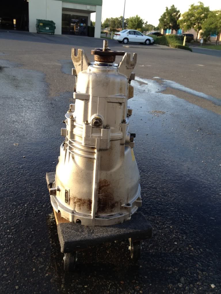

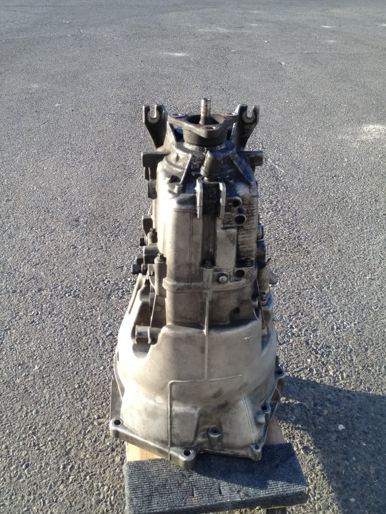

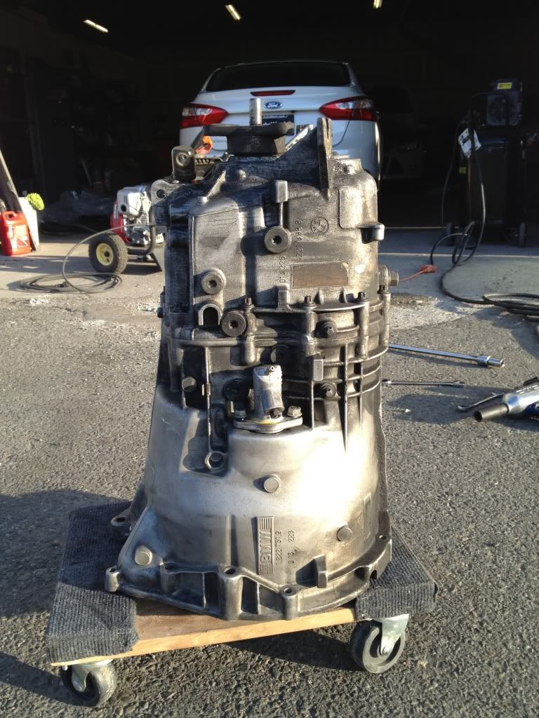

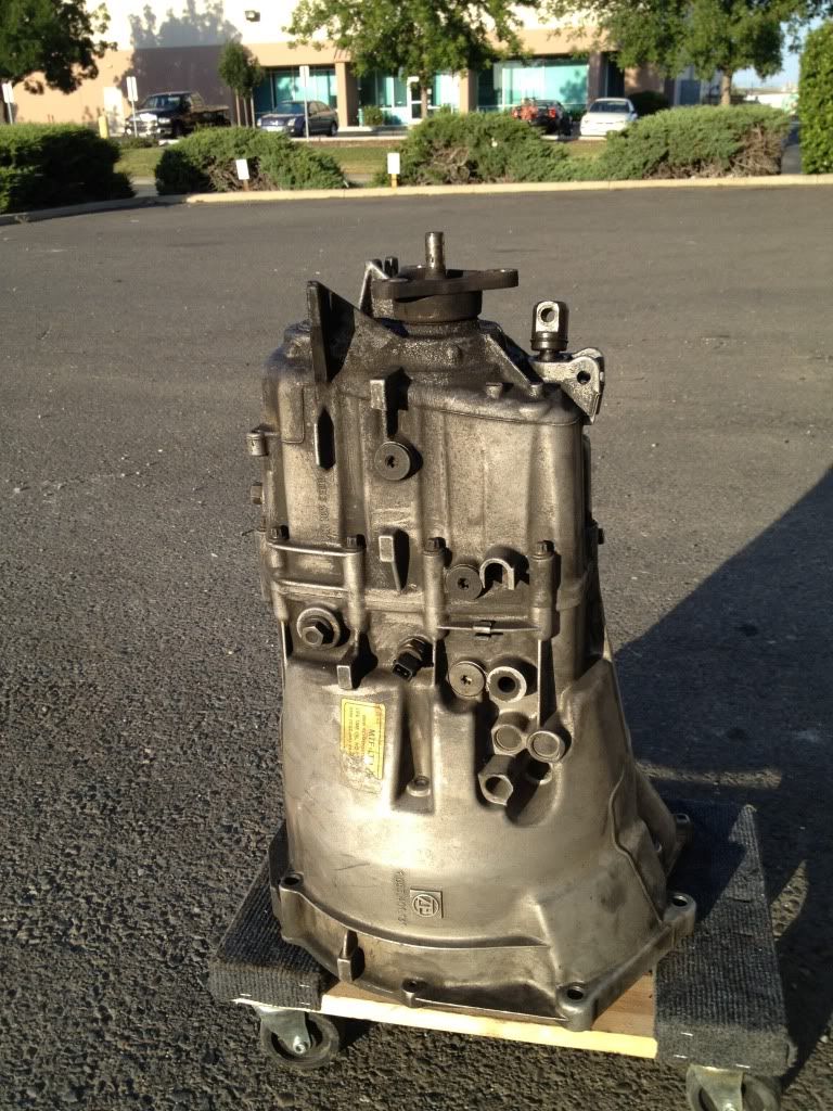

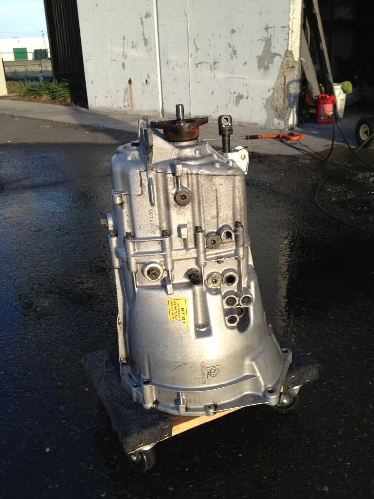

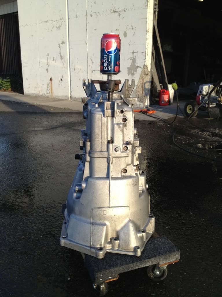

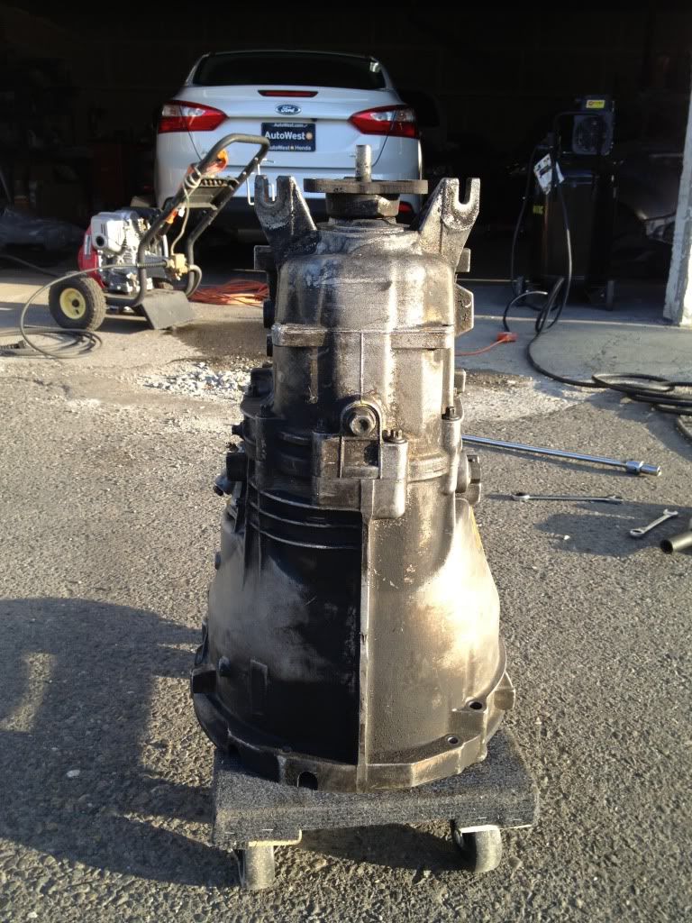

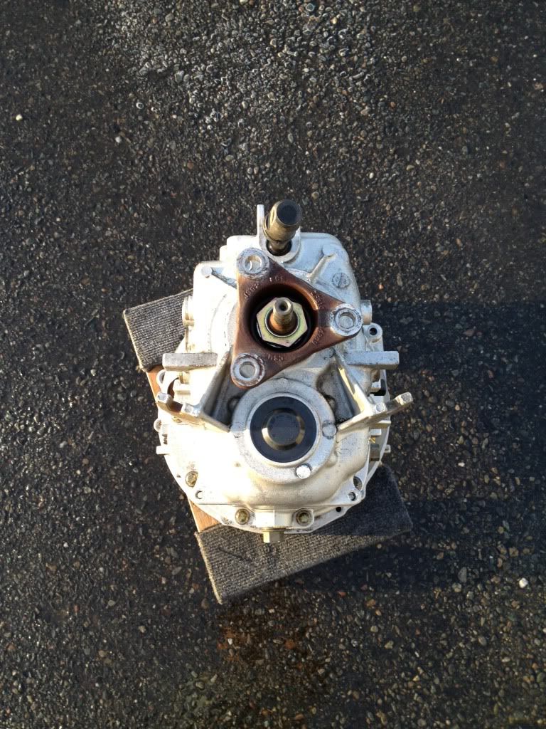

    ALSO, I got the transmission cleaned up and resealed it.
    BEFORE
    AFTER
    Everything is cleaned up and looking purdy.
    Now I have to go to Auto Heaven and borrow a thin walled 30mm to get the output nut off so I can install a new seal. Also, I'll drop off my OBDII headers (BTW, they are 2xs lighter than the cast iron ones) to get the EGR port welded up.

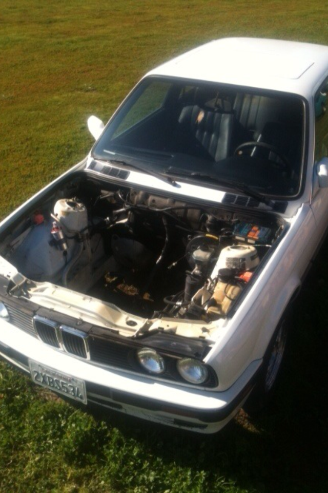

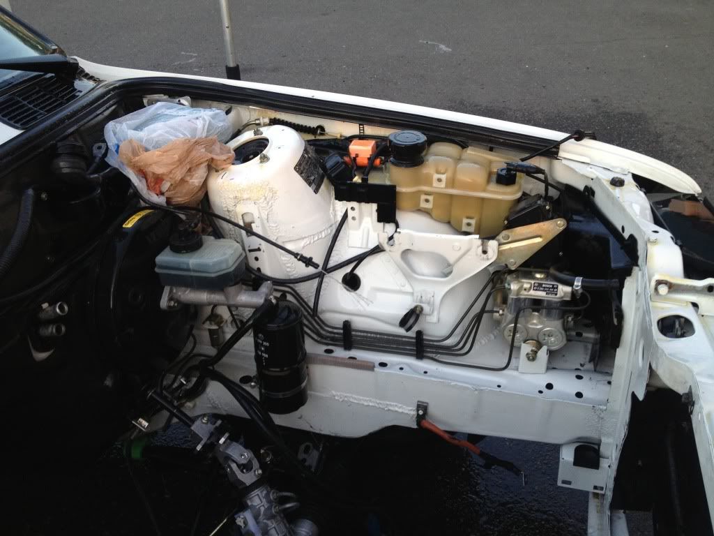

                    7.24.13 update

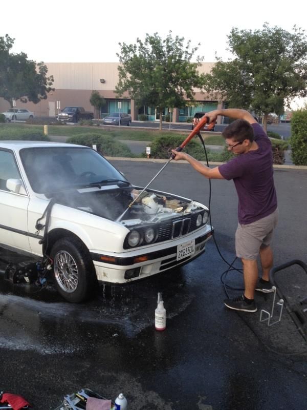

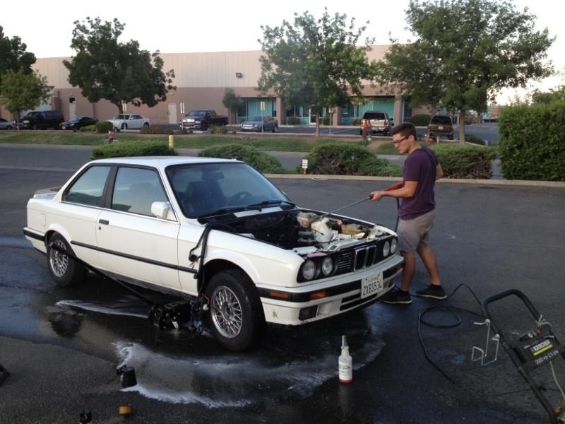

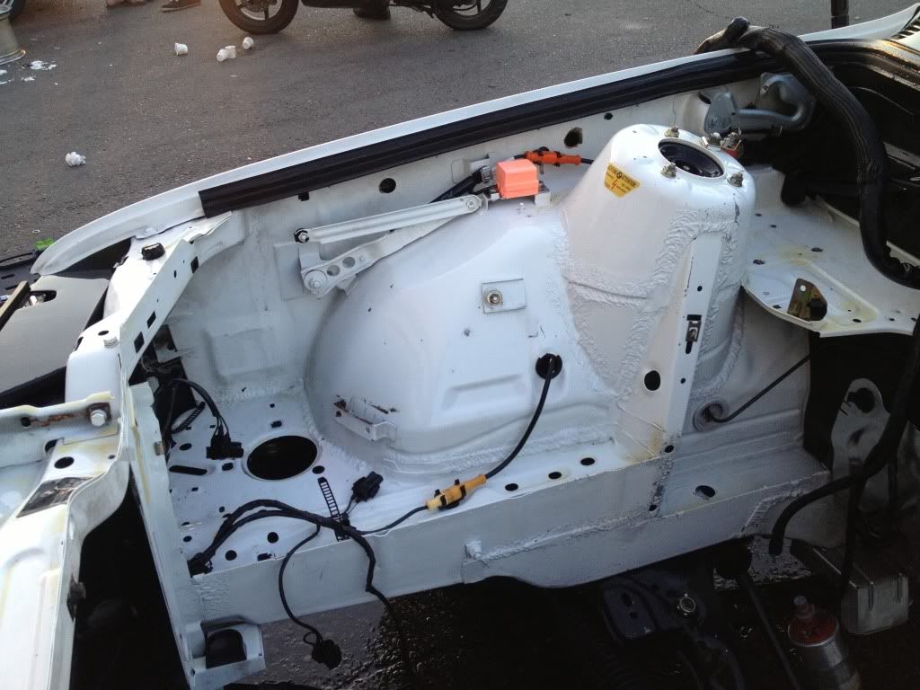

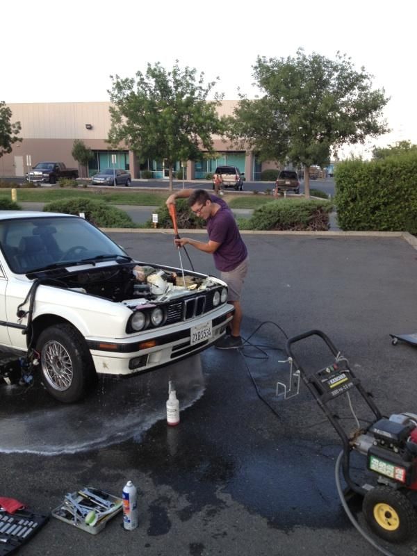

                    ENGINE BAY BATH TIME :):):)

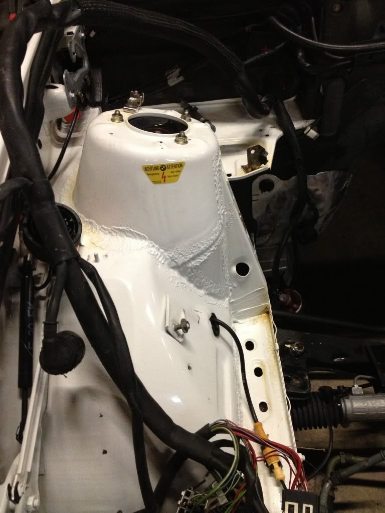

                    Before (you can't even tell how yellow and nasty it really was)
                    AFTER
                    I got this result using the following items:
                    1) "Gunk-Off" foam
                    2) "Gunk-Off" non-foam (above products only got surface dirt off)
                    3) *Professional grade degreaser (*more like witch-craft grade)
                    4) Pipe cleaners, brushes, and steel wool
                    5) Pressure Washer
                    There was a lot of yellow crap all over the shock towers and a lot of oil on the rails. After spraying the degreaser and just agitated it with a brush lightly, all the crap came off and made the engine bay sparkle like Orbit Gum! ;)

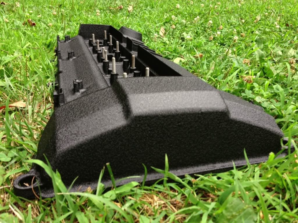

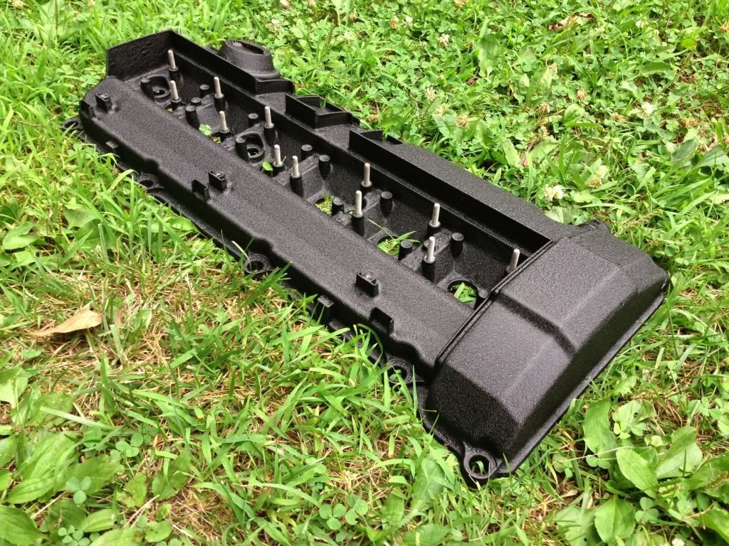

                    ALMOST FORGOT.......Dave @ Renewed Finishes sent me pics of my finished valve cover
                    I'm stoked.

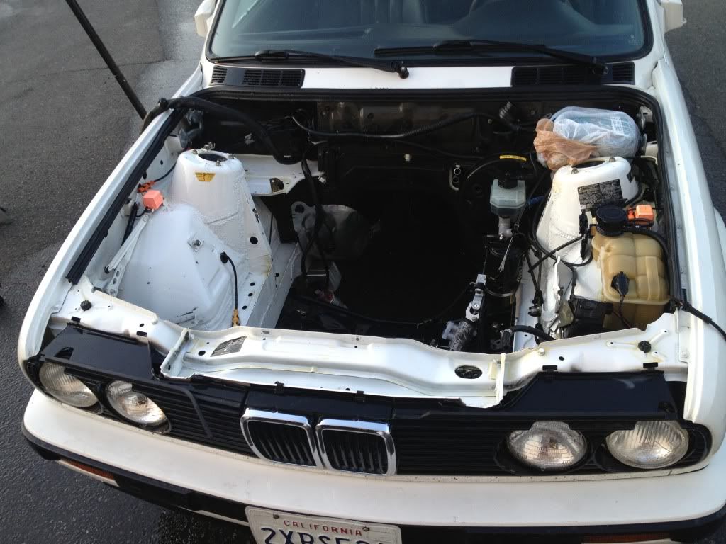

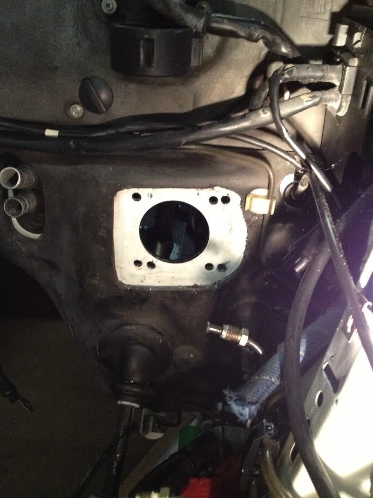

                            I finally got to prep the e30 for the transplant.
                            First things first - MOVE THE BRAKE BOOSTER. I decided to use my stock booster and MC to retain the stock brake feel. I talked with Igor @ Auto Heaven and he said the e21 brakes are not enough for a 24v swap.
                            BTW: I was sort of dreading this step for 2 reasons:
                            1) I hate working under the dash area b/c im on a tiny monkey
                            2) I've never cut metal before, and this was the firewall of all things! :o
                            I put my fears behind me and just went for it, slow and steady.
                            I drilled exactly 1/2" and opened the whole a litter bigger

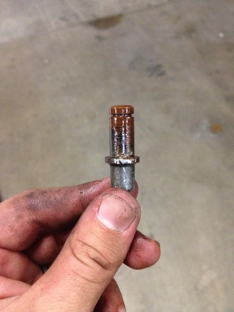

                            Then I had a really tough time getting the pin out of the clevis because it was rusted. After 20min of banging on it with a chisel and crowbar I finally got it out.
                            The next day I went to Pick-n-Pull and got another clevis so I can do this DIY:http://www.r3vlimited.com/board/showthread.php?t=250474
                            MadMax (the guy with the F20c turbo powered 2002 on here BUILD THREAD HERE: http://www.r3vlimited.com/board/show...ight=f20c+2002) was kind enough to weld up the clevis on his free time.
                            I got back to the shop, got the modified clevis on the booster, cut the bottom passenger side stud, installed booster, and (after 30min of trying to line everything up) I got the pin though BUT.....
                            I screwed up 1 hard brake line (closest to the FW) after I bent the line by hand and tried to install on the MC. It appears that the threads on the line are very delicate because they pretty much stripped out when I tried to install the line on the MC. I was a little cock-eyed (I thought it was pretty good for a bend-by-hand) but it just wouldnt thread on. Now I have to go to pick-n-pull again and get another hard line and bend it a little better.
                            ALSO, I'm going to have to re-degrease the bay again because I got brake fluid all over it because I bench bled the MC.
                            Overall - I took 1 giant leap forward and a little step back. :???:
