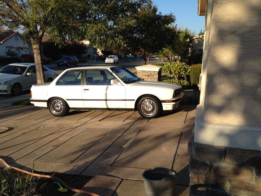

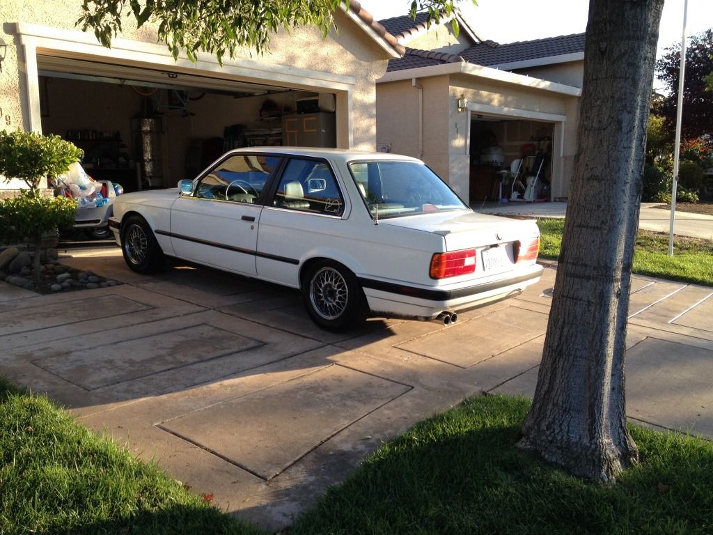

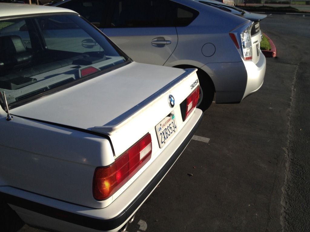

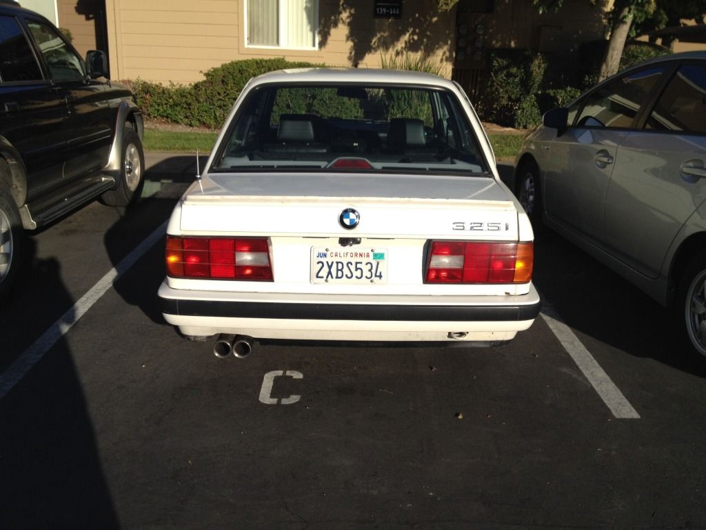

                                #75
                                UPDATE 10-16-13
                                I've been daily driving the car for almost a week now and I LOVE IT!!! I've been breaking in the clutch so I haven't done any hard acceleration but the mid-range torque is very nice.
                                So far I have a few small problems:
                                1) idle is a little low (650rpms)
                                2) when idle is that low it seems to miss a little and then it'll rev itself up intermittently. Does it 2 out of 10 times that I stop at a red light. (maybe vacuum leak)
                                3) The manifold is touching the booster so I have a vibration at 2-2.5k rpms.
                                4) On light to medium load in all gears its feels like the vehicle is getting pulled back, like brakes are being applied for a seconds and then released.
                                5) Need to get a kamotors CAI system before I suck up some crap into the MAF.

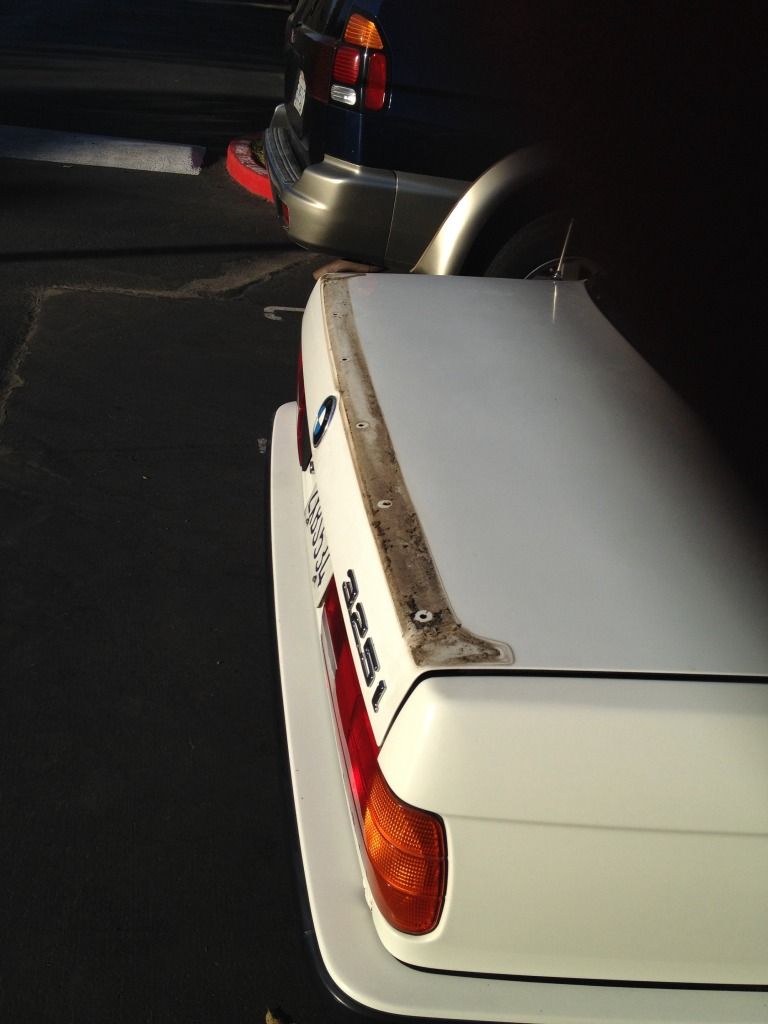

                                Besides these things I've loved every minute. Here are a few pics of how she looks after a good interior and exterior wash.
                                Took off the flaking lip for repaint.
                                This was the result of 20years of filth.
                                NEED TO DO (cosmetically):
                                1) Eliminate the reverse rack
                                2) buff and polish
                                3) re-paint the front clip and re-paint all black rocker panels
                                4) get tires and install new wheels
                                OVERALL: :):):)
                                SEE THE MOST BORING M50NV BUILD THREAD HERE: http://www.r3vlimited.com/board/showthread.php?t=288275
