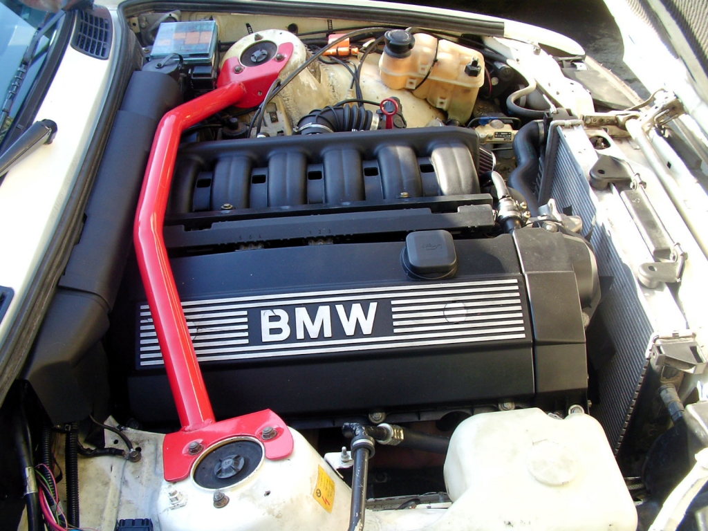

                  i have a 91 318is and here's my engine bay shot. i didn't see any studs grinded when i installed the harness covers. i broke one of the clips, hence the tie strap;)

                    that install looks really clean. I hope mine looks that good when I'm done. thanks for all the tips guys, this is going to be one mean machine when I'm done with it.
                    bmws50b30 - have you weighed your car at all with the s50 in it? is that the 320i brake booster I see in your engine bay? did you have to shave the intake manifold fins? from the last pic it looks like there is plenty of clearance
