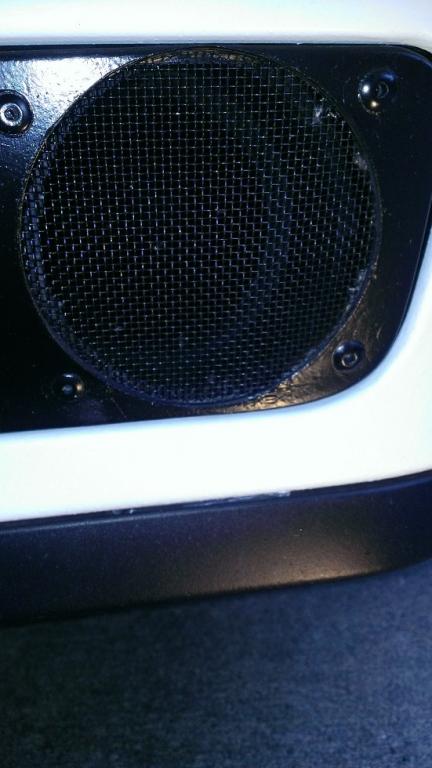

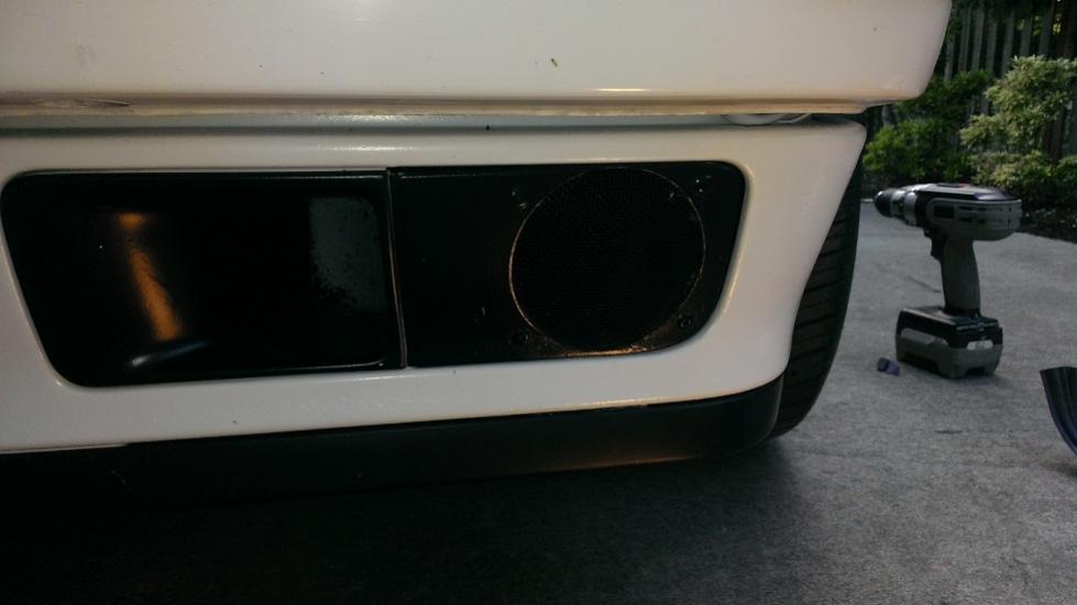

    First step: opened the Euro grills and the Smiley housings with a dremel to get air from the grill area. Then cut a 3" hole in the foglight blank...
    ...screened it, painted it, and then cut a 3" hole in the tray behind the headlights.

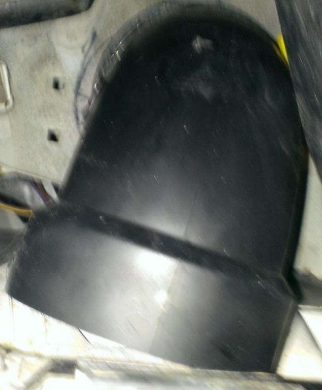

    Installed a 90' resin elbow from the foglight opening to the airfilter space.

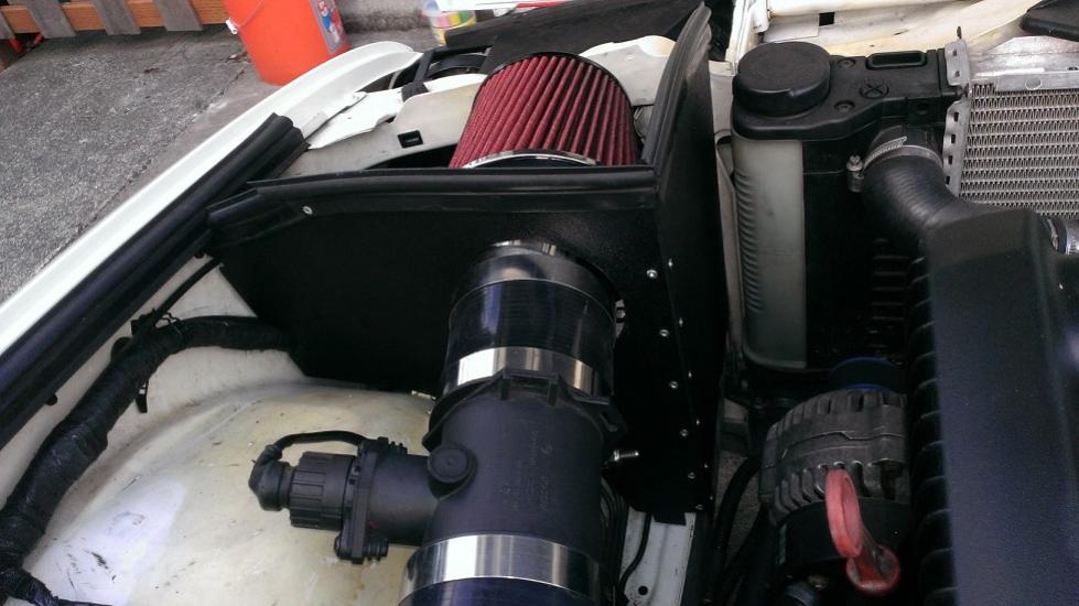

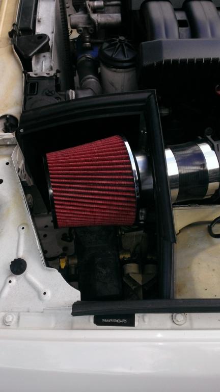

    Bought airfilter, silicone tubing, stainless sleeves, clamps, 90' 3-->2 1/2 silicone elbow and a port to go from the 3" AFM down to 2 1/2" throttle body (port on the bottom for ICV).
    Made a template from posterboard scavenged from my 3rd grader's art supplies and cut plastic to create separation from the engine compartment. Topped with factory hood gasket.

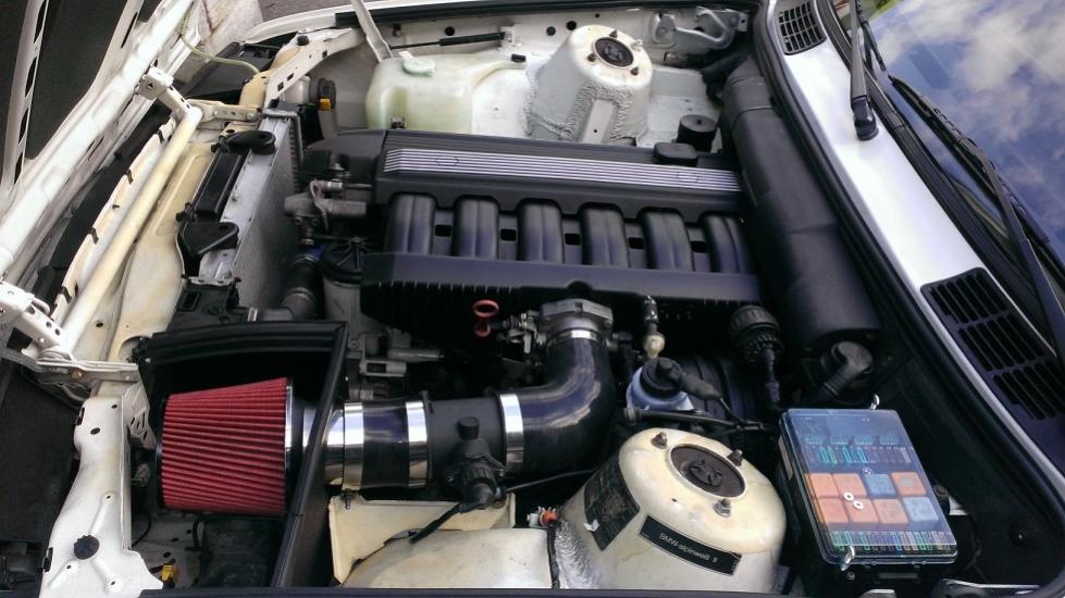

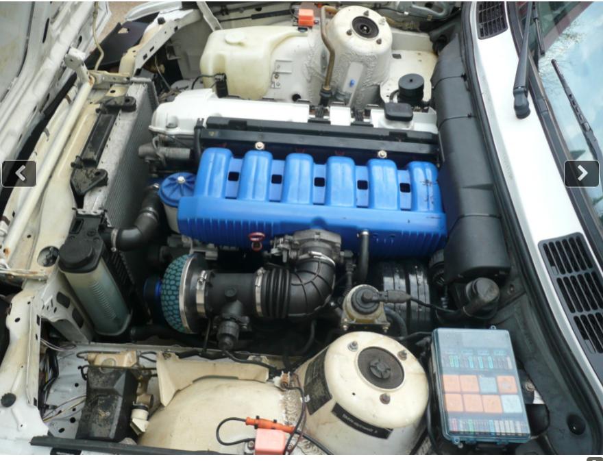

                        A factory airbox wouldn't fit. If it did I would've done that! I do think that the cold air setup I made is better than just a filter inside the engine bay. This is how it was setup when I bought the car:
