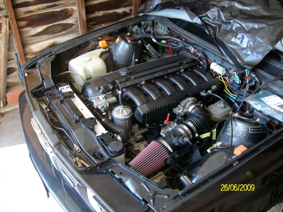

            #305
            Originally posted by C-T
            Sure.
            How do you guys mount the relays as shown in the bottom right of this picture? Is there a stock mounting piece that allows for this or is it custom work?
            thanks

              #306
              the m20 harness also has a place to mount thhose three relays just infront of that strut tower. thats where i put mine, using the relay cover from the m20 harness and everything.
              see these two pics infront of the radiator resevoir cap. (mind you these were taken days after my swap. so foget how the wiring in the back looks)

              • Lof8
                • Oct 2006
                • 2827
                #307
                I see. I'm more interested in getting them near the fuse box as I will need that relay mount near the shock tower for my remote brake fluid reservoir. thanks for the info. anybody got anything for mounting them near the fuse box?

                • ian332isport
                  • 124
                  #308
                  They actually clip directly onto the fuse box. There's a number of positions that you can use as well. You can see them in this picture of my engine bay.
                  • Lof8
                    • Oct 2006
                    • 2827
                    #309
                    very cool!
                    thanks
