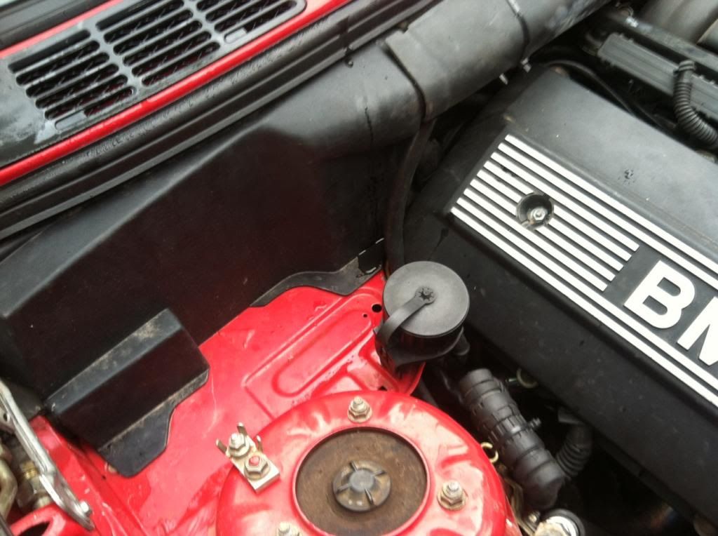

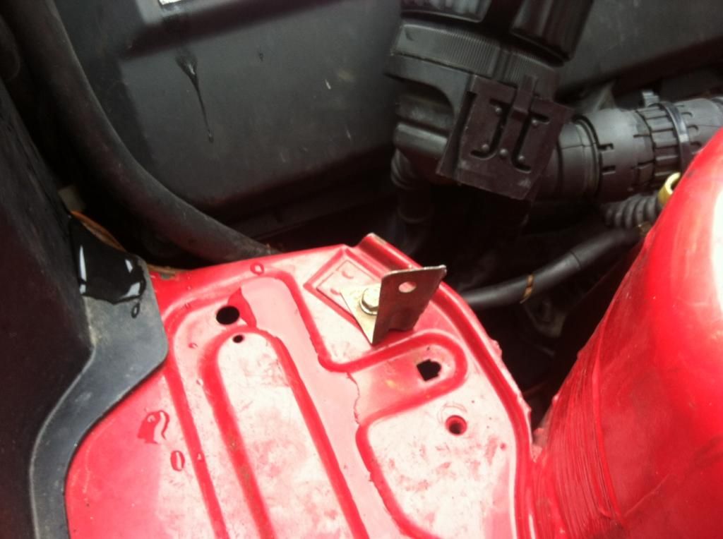

              Yep you need to look at which studs it uses and break the other ones off to get it to sit flush. For the diag connector trim the metal bracket on the corner of battery tray to clip it to.

                • agent
                  Vice Grand Pubaa
                  • 7960
                  ^ That's where mine is.
