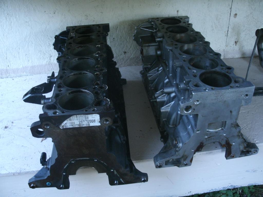

    Had these sitting side by side on my shelf, so thought I'd weigh them just to see definitively what the real weight difference is between the aluminum bblock and iron block m52. I know there has been plenty of weights posted all over for these engines fully dressed, but I always wanted to see two stripped blocks weighed on the same scale, same day, for my own eyes.
    For the record, the iron block is an m52b28 pulled from an e39, the aluminum block is also an m52b28 pulled from a 97 z3. Neither have any rotating assembly, are stripped bare.

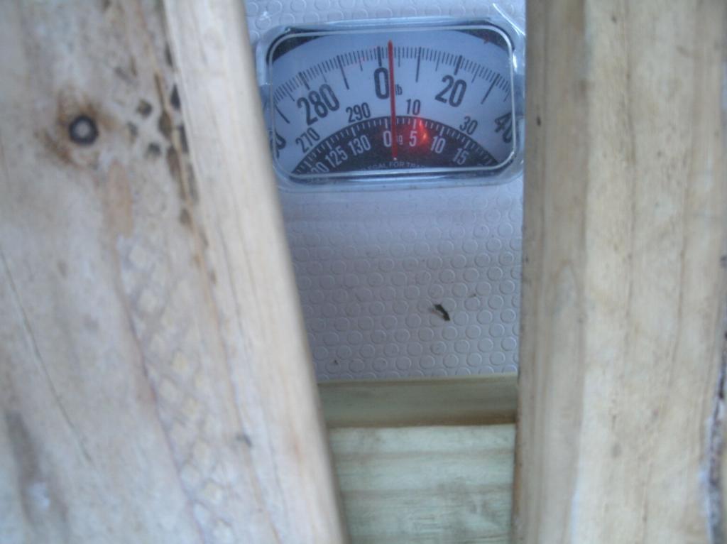

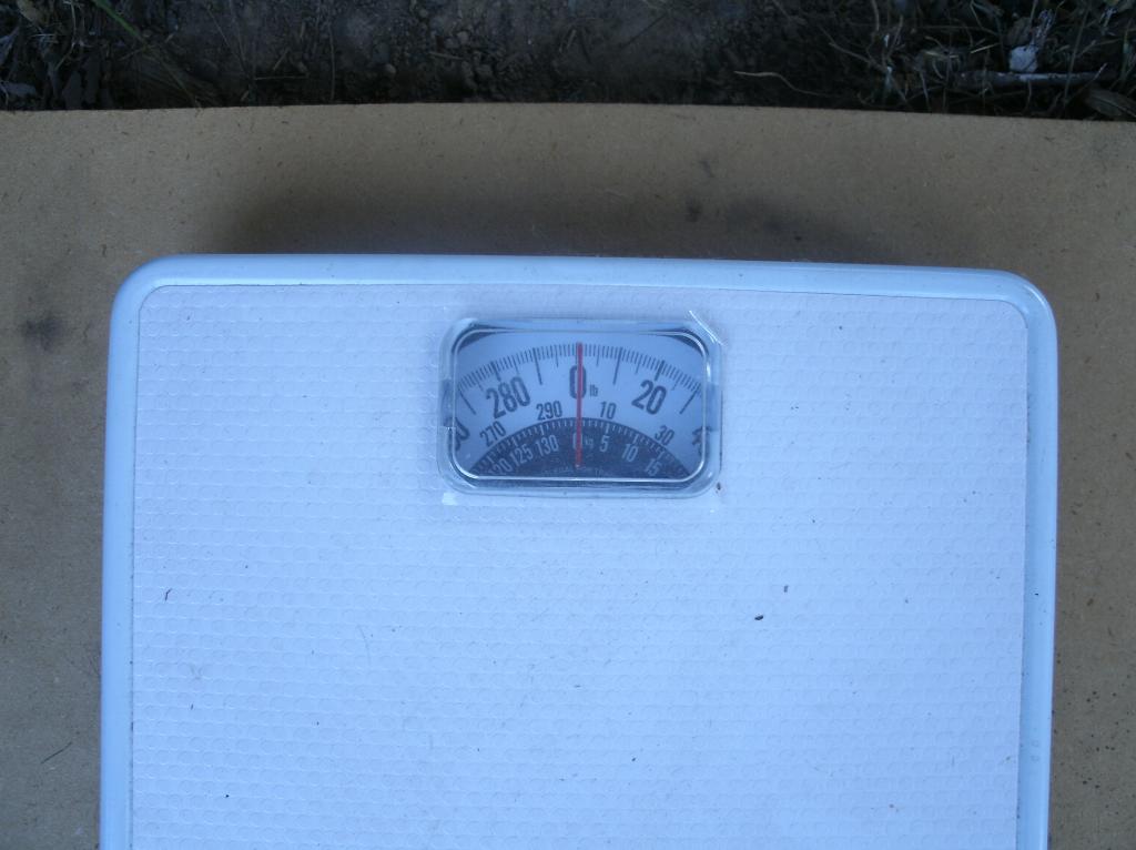

    -First the scale by itself
    -Then the scale with some 2x4 blocks arranged to support the
    blocks while weighing
    -Iron block on the left, aluminum on right

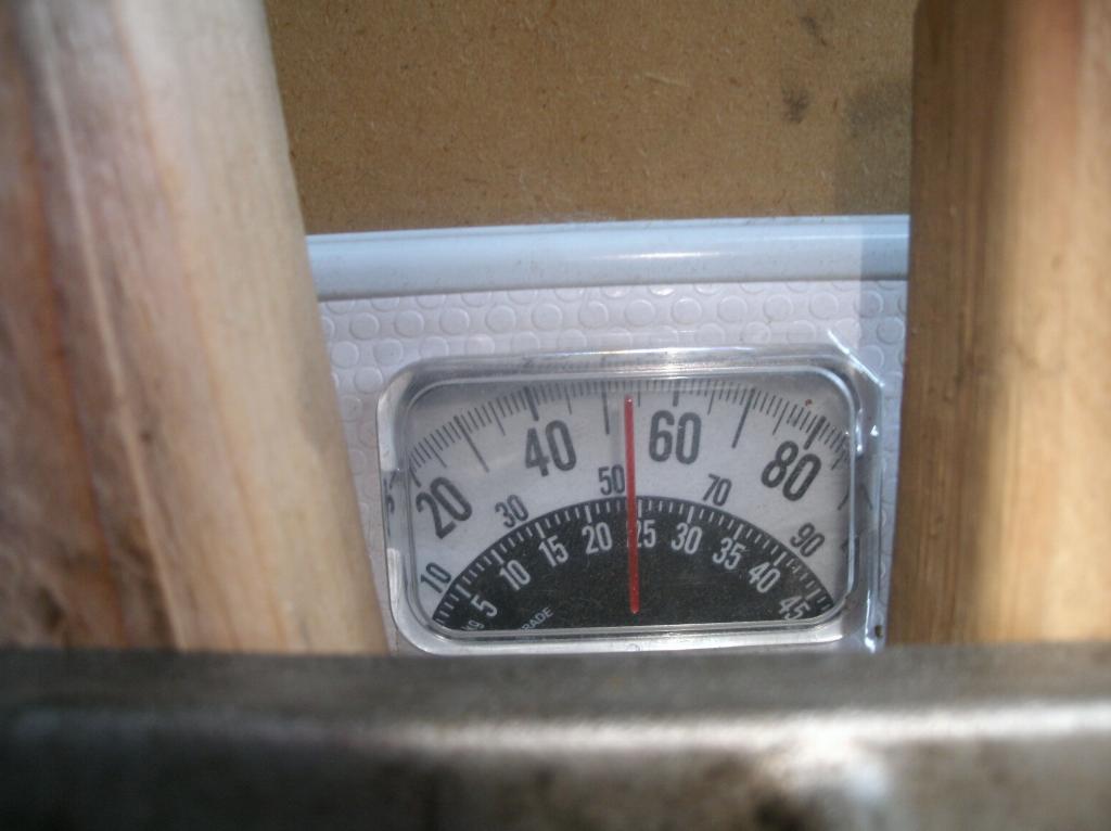

    -Aluminum first

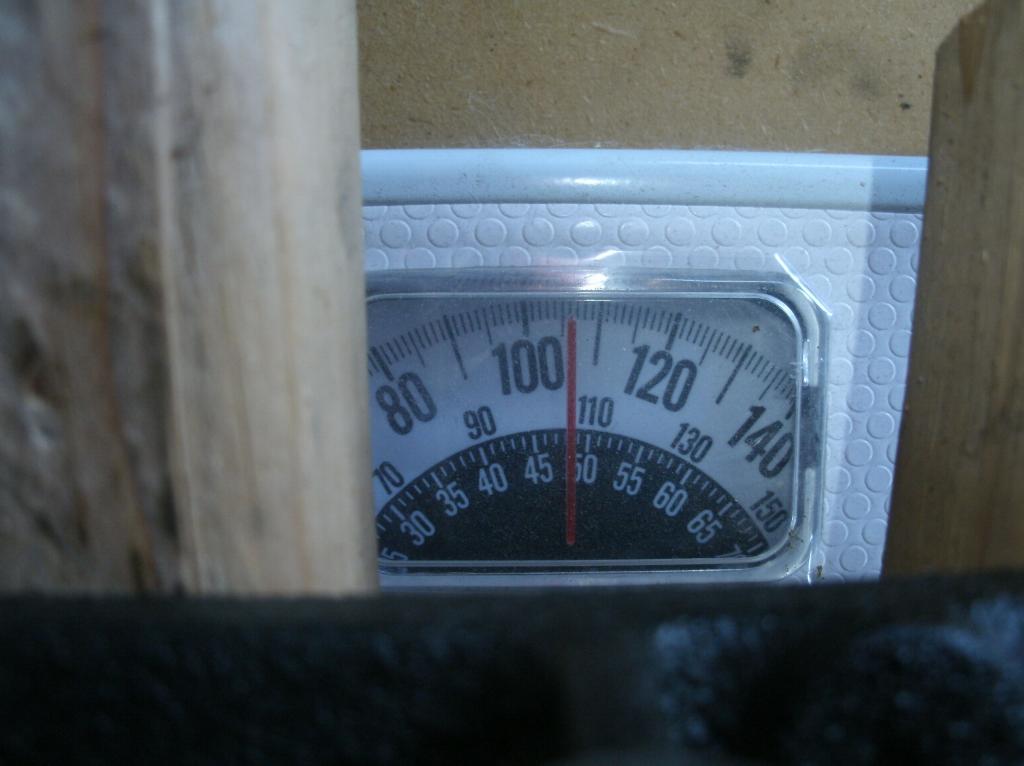

    -Iron block finishes it up
    So, this is a cheap scale, it could be off by a couple pounds. But to me the important thing is not what each block weighs, but the difference between the two, which should be pretty accurate based on same scale, same method.
    The figure I've been hearing tossed around for weight savings of the aluminum over iron block has been 60lbs. Based on this side by side comparo it looks to be more like 52 lbs. I apologise if the weights are difficult to read in the pics. In person I read 106 on the iron block, 54 on the aluminum. Adjusted for my platform this would be 103, and 51 lbs.
