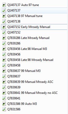

      The bins that I uploaded are definitely not stock. I have the original read from my ECU and I can upload it somewhere too if wanted. Its completely unmodified for sure. I am going to redo the EWS, SAP and rear O2s on it to go back to the stock fuel and spark maps. I wouldn't mind getting a copy of the MS41.2 XDF to look at and figure it out a little more if you wouldn't mind 328iJunkie. I'm thinking of going turbo within 5 years on an M3 (the E30 really probably isn't meant for it...) and I want to attempt to learn it myself. What all is defined in it? I have one from RomRaider but everything is uncertain. I also think Im going to use a more steady form of flashing. The quality and software behind the Galletto is a little shaky.
      I think someone put you down earlier about the information you gave out Dave. If it weren't for you, I might still have my bin files, but I wouldn't understand nearly as much about them. Thanks for all the help, and still remaining to make money from tuning/reflashing.

                            I know I'm bumping a thread that I started nearly 5 years ago, but a LOT of new information on this topic has come around and I wanted to share to help out anyone who is still struggling with this. I've graduated college in 2015 and went to work, picked up a few other expensive and time consuming hobbies, so I apologize for not posting sooner.
                            I wont go into a ton of detail, but my sister post on bimmerforums has tons of information there as well.
                            Basically the new best method is to go to RomRaider, download their software and get the developed definitions for the MS41.X. I wont repost the instructions, but go to the following webpage and follow the instructions to get all of your software/hardware up and running.
                            EDIT - December 6th, 2020 Instructions below are really old but helpful until the content is moved into appropriate locations. Therefore, this will remain here for the time being. TJABO - WORK IN PROGRESS INTRODUCTION:RomRaider is a great little free engine tuning program, developed originally by
                            A lot of folks much smarter than I have developed all of this information over the last 4 years or more, and it breaks down almost all of the data in the MS41. The EWS delete byte is not listed by name but it is shows as "Byte 8" in "Control Bits" Section. itll be default 22 for MT cars, and 20 for Automatics from what i understand. Swap this up to 150 or 148 respectively and you should be in the clear.
                            There are other check boxes/radio buttons for the other options such as Rear O2 deletes, and Secondary Air Pump removal.
                            For full disclosure, I haven't tried to flash my ECU with the new romraider tool because frankly I haven't had the time, but I will try to do that this weekend and report back if there is still any interest in this topic.
