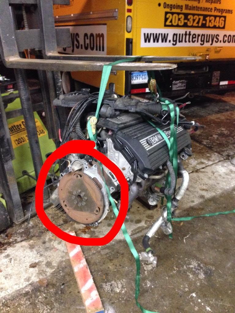

                          ok i bought m12x1.75 80mm hopefully they work. just trying to get this stupid auto flywheel off so the stand will mount to it i wasted liek 1.5 hours last night because of that stupid flywheel. couldent get it off cuz it kept turning when id try to losen it. any thing i can use to keep it from turning whe i go to losen it? i lack an impact gun atm.

                            Im trying to get that thing off

                              Remove the 8 bolts?
                              You'll also have to take the starter off to put it on a stand.
                              Edit sorry didn't see your previous post. Try putting the end of a pry bar in the tooth of the wheel and bracing it against something. That's what I had to do when torquing mine down. Worked ok
