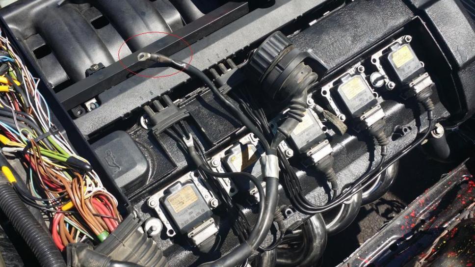

        you need to ground the highlighted wire to the passenger side strut tower. Is your fuel rail harness small brown wire grounded in front of the engine?
          Yeah I left that circle wire connected the second wire I put to the power terminal. Yes the ground wire is solid I even took it off to clean the connection just to make sure the bolt wasnt corroded or anything.
