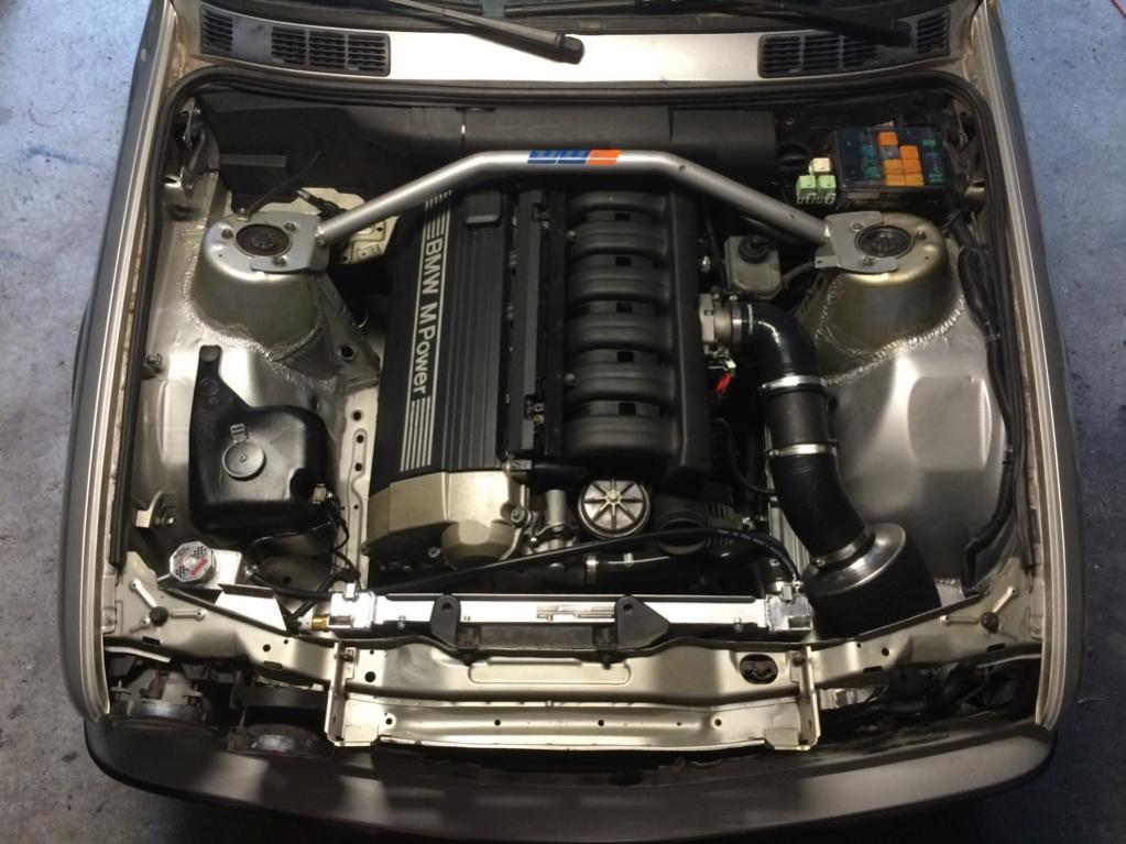

                          It going to be the summer car yes. With some tracking on the side but not too often. My IX will be the winter beast. And i was looking to get mandrel bends and at least one V clamp or something to make it separate pieces. Heres a picture, race lands aren't on yet, i have to get those modified to clear tranny...
