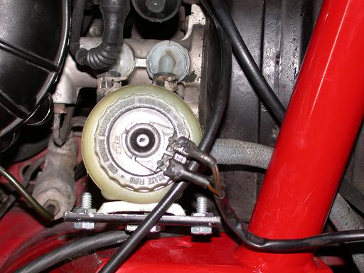

The jag pieces I mentioned before wouldn't fit properly.
I found that the DSM fittings were the best fit for the Girling master cylinder. You'll need the grommets, the 90 degree elbows, hose and reservoir.
For my install I wound up using the BMW 2002 remote reservoir since it makes for a cleaner install, it integrates the clutch line and you can reuse your existing brake fluid level and wiring. Crappy picture attached below.Comment
got any other pics? like maybe from the side?My 2.9L Build!
