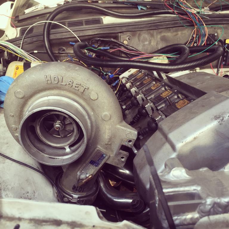

    I currently have the engine and trans mounted in the car, sorting out some wiring with Megasquirt as its my first EMS I have wired alone it's quite intimidating...
    Heres a money shot with manifold + Turbo mounted
    Before Clocking just because I wanted to!
    After Clocking for fitment! Also check out CXracing Radiator and fan fitment through grill!
