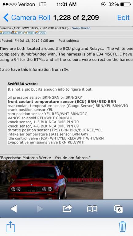

    Labeling My Harness
    I'm in the middle of ohming out my harness to label the connectors, and I have most of them figured out, but I've read multiple times that the E34 harness has extra connectors that are E34 specific such as ASC+T.
    Those threads are now either deleted, my imagination is crazy, or I'm lacking some terminology on what to search for.
    Can somebody help me identify some of these wires/connectors I can get rid of to thin out my harness?
    Thank you.

      Here ya go. Please make note that this is for obd1 cars without asc.

        The definitive way to do that is to refer to the ETM for the harness you have. You can identify wires/connector functions two ways. Use the ETM to find each connector and the colors of the wires to identify its function. Or you can carefully tug/pull each wire from the connector to identify and follow it all the way back to the DME connector where you can use the DME pinout to verify the function.

          I actually ohm'd out the connector to the X6000 to figure everything out.
          Thank you for everybody's contribution.
