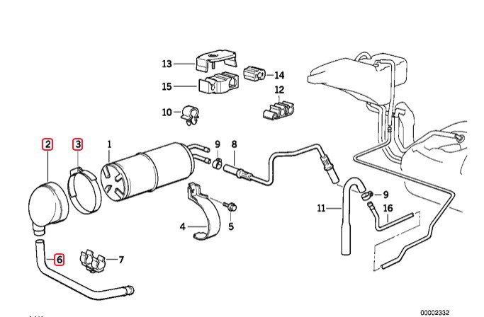

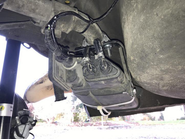

      I'm not chiming in to say what you did is wrong, as it's a fine solution, but I'm going to pass along a couple alternatives that don't require drilling holes in the car, including one that is super simple. The shut-off valve (vent solenoid) is the part that makes installing the E36 charcoal canister necessary to begin with. So with that in mind, you can simply install an external shut-off valve and keep the E30 charcoal canister. Just put the cap on the bottom from an M60 car and attach that to a shut-off valve from a Volvo or Hyundai. The Volvo one is part # 9486016. It has a Volvo connector so make sure you get one of those, but if you want one that has the same connector as the BMW version get the Hyundai one (Edit: There's a Volvo one with the standard BMW (Kostal) connector with part # 9135805. It has an air cleaner attached to it.) The Volvo one is the same Pierburg brand. I couldn't found a Hyundai one that's Pierburg brand. The other solution is to install the Z3/318ti charcoal canister under the car. That's what I did on mine. I modified the bracket to attach it to a U bolt on the fuel filler pipe and a heavy duty zip tie on the other end. That way it's reversible with no permanent modifications.
      Click image for larger version  Name:	IMG_7029r.jpg Views:	0 Size:	63.9 KB ID:	9969808 Click image for larger version  Name:	Cap for E30 Charcoal Canister.jpg Views:	0 Size:	44.5 KB ID:	9969809 Click image for larger version  Name:	tkcm9N3.jpg Views:	0 Size:	60.5 KB ID:	9969810

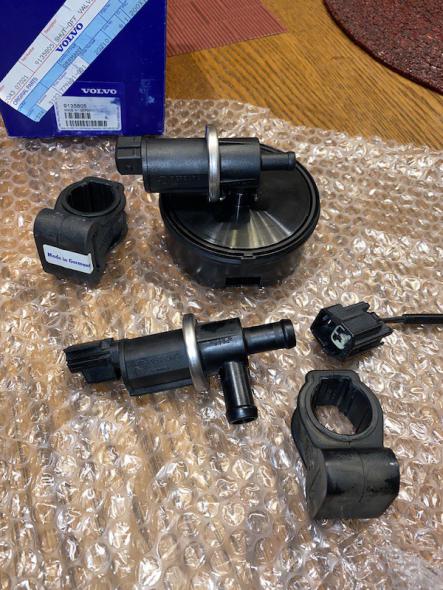

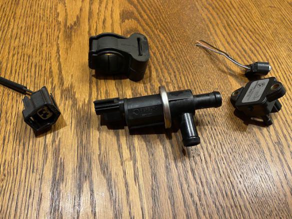

        Here's the shut-off valve with Volvo part # 9135805 compared with the other one. This looks like the one to get. Same connector as the BMW one and it comes with a dust filter attached to it that is removable. I was looking at the Volvo parts diagrams and the other one is suppose to have a dust filter attached too that's at the end of the hose, so may as well get the one that comes with one already.
