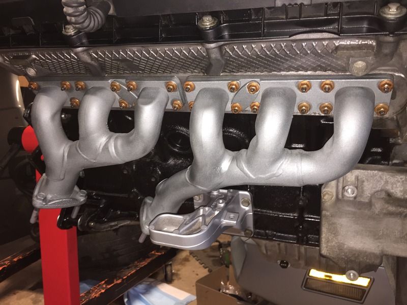

    who has done it? How many threads are left for the nut to grab once the manifold is in place? Hoping I won't need to put a bb in the hole like some have.
    In the process of putting new studs in my S50 head but thinking of using the N54 studs now instead of the S50 ones.

        Here's a pic of my s52 with the N54 studs if that helps. They seemed to work fine. Just tedious getting the old ones out!
        -Geno
