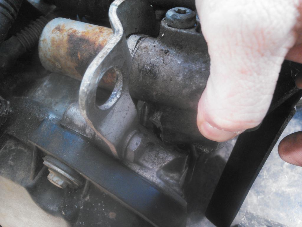

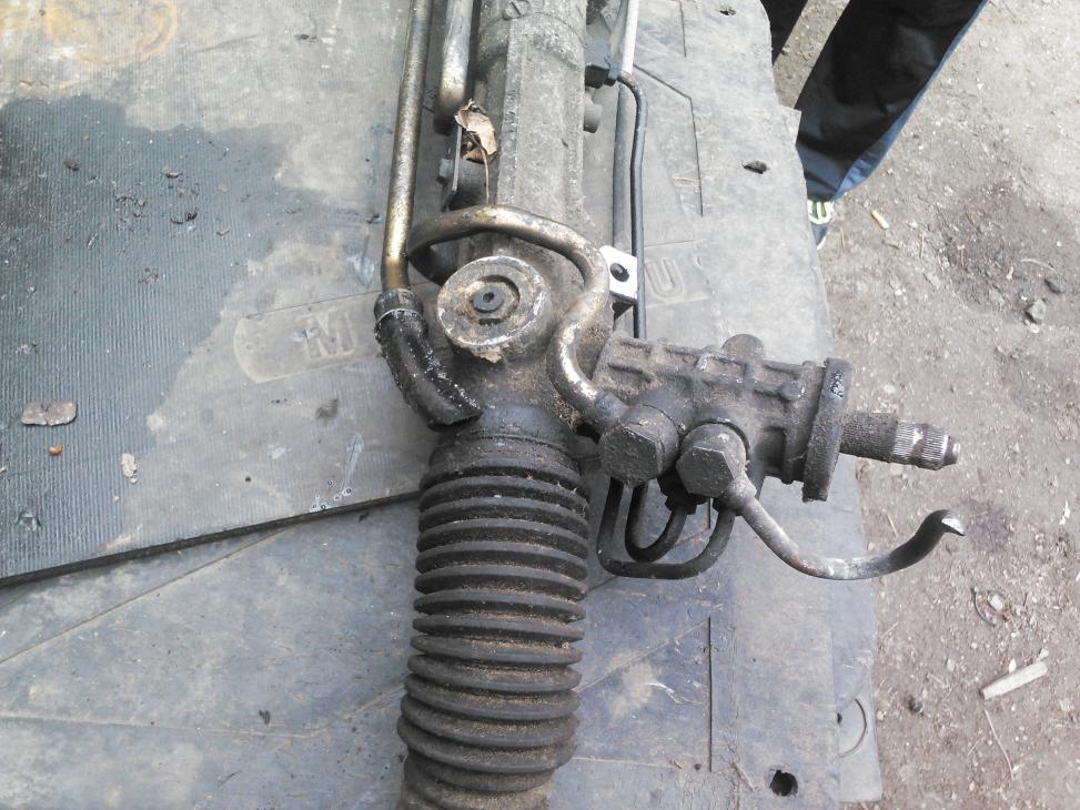

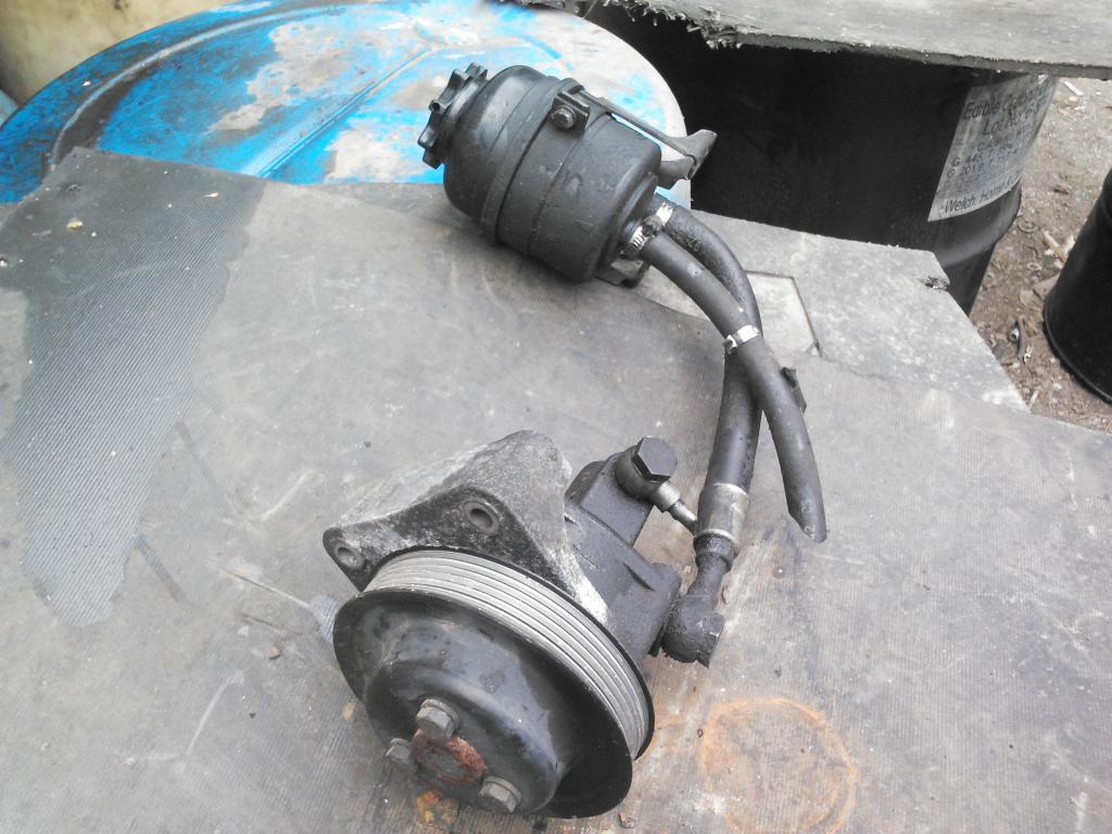

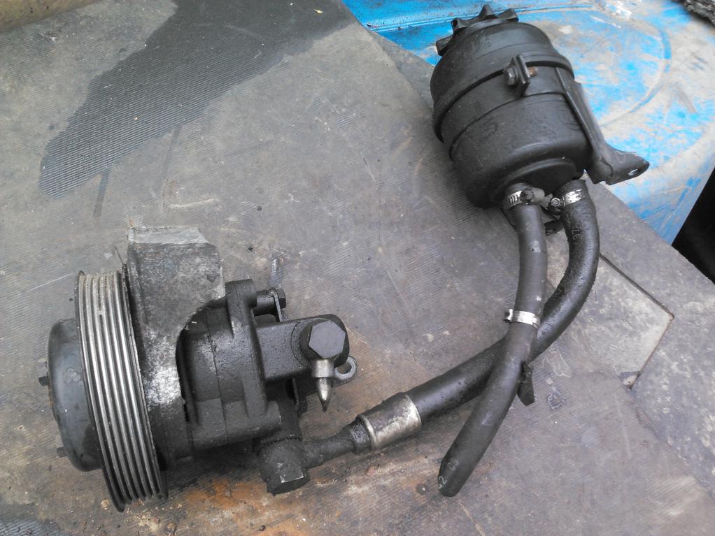

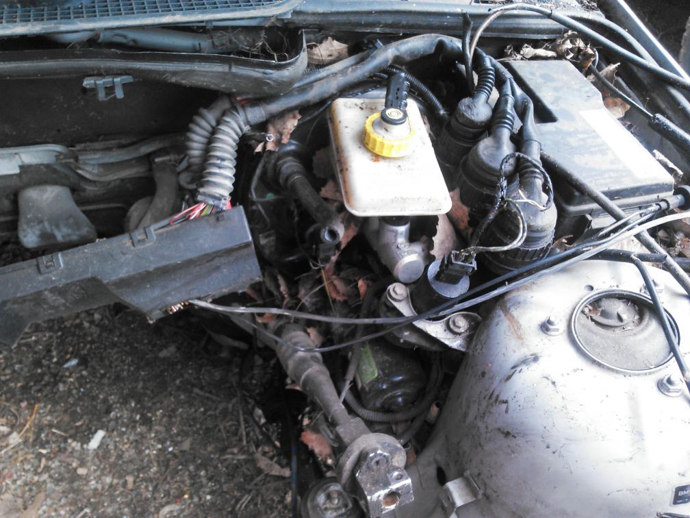

                            They cracked a cover on the front of the engine, see pics and they also hacked out the power steering pump and rack. They cut the plumbing hose for the rack and one pipe on the pump. Are these worth the $100 the salvage yard is asking?
                            • clydesdale
                              • 631

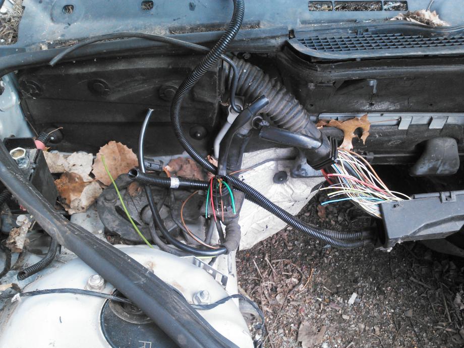

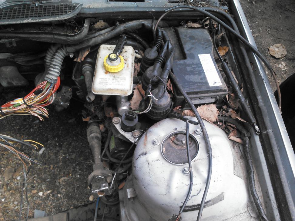

                              Is there anything in these engine compartment pictures that I need?
