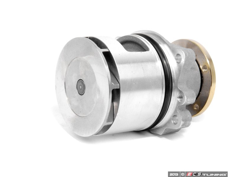

          Thanks for the input. Yeah I was going to do some basic stuff like gaskets and plugs. I didn't know about the vanos gasket or thermostat housing but I'll add them to the list. I was also thinking about getting an upgraded water pump and maybe some ARP head studs.
              Let me know what you guys think.
              I didn't know about this issue, could you elaborate on it?
              That water pump looks like total bullshit. How there can be more water flow with smaller impeller fins.
              Stock:
              Just buy the stock water pump. It's enough for even +1000hp engines if it's just not broken.
                        Stock:
                        Yeah, I was wondering the same thing. I guess it doesn't make sense that the stock price is 40 compared to 200.
