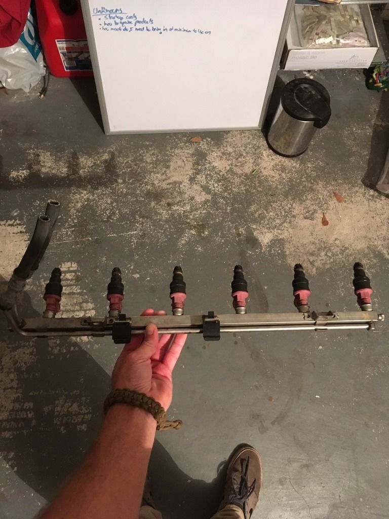

      Thanks for the input. is there a reason I would need a new fuel rail? I have an m52b28 out of an e39 and I have the fuel rail and pink top injectors from it.
        Nope, if you got your engine out of a 528 you're probably all set. Take a look at your fuel rail and see if it has the fuel pressure regulator at the end on the back.
        For a visual, go to http://www.realoem.com/bmw/enUS/show...diagId=13_0411 and check if you have part number 6 already in part number 1.
        Sent from my Nexus 6P using Tapatalk
        • haaken675
          • Sep 2016
          • 601
          Ill take a look when I get home today. I can't remember if it has the FPR on it or not, but I'm thinking it does.

                          If by running losses fuel rail, you are referring to a return style fuel system, then I think thats what I have.
                          This fuel rail I was given with the motor does not appear to have an integrated fuel pressure regulator. Did the e36 motors not have the integrated FPR? The casting numbers on the block indicated it was from a 528i, but the guy I bought the motor form told me he was told that it came from an e36...And the plot thickens...
                          An as far as the MAF, I was thinking about doing cat or schtick cams potentially, so I thought a bigger maf, throttle body, and potentially injectors might be a good thing.

                            So I have been doing some searching. It sounds like I would be better off getting an e39 m52 or an e36 m50 fuel rail with an integrated FPR? I looked up the diagram on real OEM for what should have come on a 328i and the 3/2 control valve s something I don't have and doesn't look like it would be easy to plumb in.
                            • jotam3
                              • Mar 2014
                              • 47
                              The only rail with the integrated FPR is the early E39 one. E36 M50's or any M50's for that matter did not come with an integrated FPR. I have an M50 rail available if you're interested, I'm in Tampa. You'd have to use an M50 FPR with it. Otherwise, if you locate a 97 528i, you can use the rail/FPR from that. See quote below:
                              Originally posted by craiggroves91
                              4. Fueling:
                              OBD2 cars (atleast the s52 cars, you'll have to double check for m52's) use a remote FPR and running loss valve that is mounted to the Frame rail. You can keep this or use a m50 OBD1 Fuel rail and FPR along with the M50 intake manifold (for a little power gain. Info about this everywhere, see step 5 also).
                              Only mod needed is a bend of the tabs on the m50 fuel rail that block the s52 harness from plugging into the injectors. Bending these tabs will no longer allow you to run a fuel rail beauty cover.........
