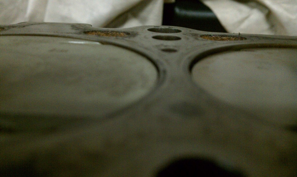

          Left: M52b28 84mm crank and 135mm rods, M50tu pistons.
          Supposedly in the low 11.x:1
          Right: stock M52B28 everything for comparison.
          Not the most helpful post, but yay picture.
