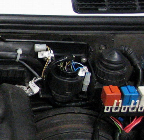

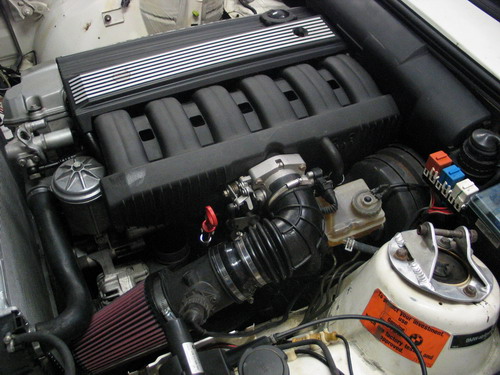

                            Here's a couple pics of mine. I was really tempted to make a nice short harness and either cut the s50 or e30 connector, but I've decided that I might go back to the s14 engine and sell the s50 after awhile, so I made an in-line connector. One end fits nicely into the stock location and the other fits nicely into the diagnostic holder. Looks pretty stock except for the relocated diagnostic connector.

                              ^^ looks clean
