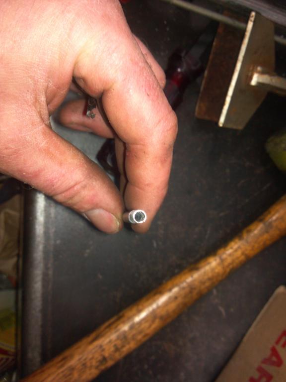

      Guys, I just threw this tool together using an old pic tool handle and a piece of 3/16 brake line.
      I opened up the inside of the brake line with a drill bit, ground down the outside of the brake line a bit, using a bench mounted belt sander and spinning the line in a drill.. and hammered the line into the handle.. cheap easy and it works!
      My POS computer will only let me upload one of the pics i took of the tool

        Another way to make a pin tool is to go buy a telescoping radio antenna (like one from an old transistor radio), and take it apart into individual sections. This gives you a nice variety of sizes, one of which will be perfect. I don't know if anybody mentioned it before, but in my case, I needed to tap on the pin tool with a small hammer to drive the pins out. No damage at all, but I was surprised that it took anything more than a little push to get them out.
