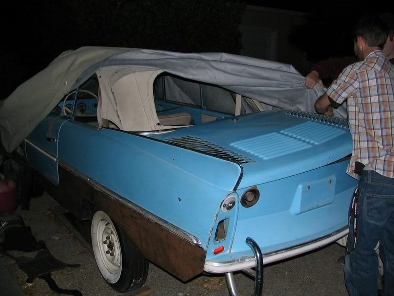

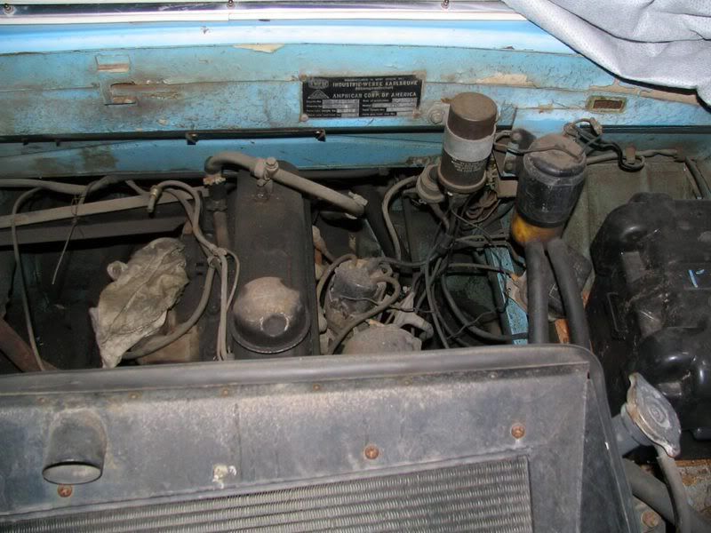

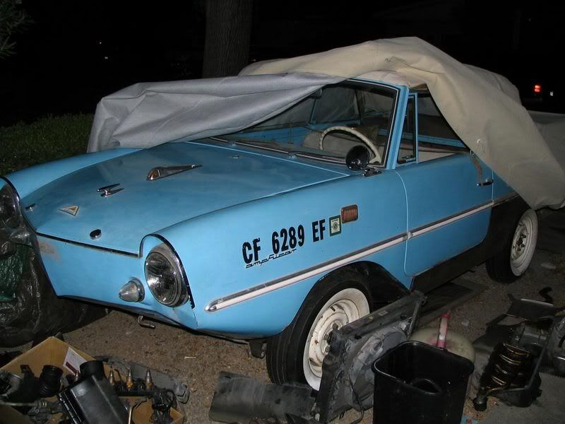

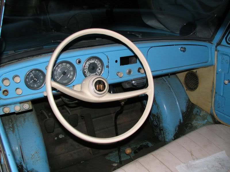

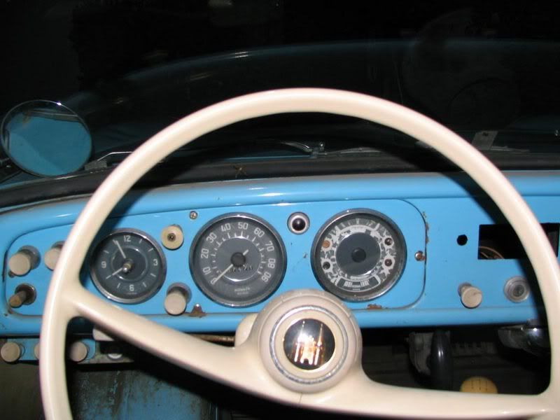

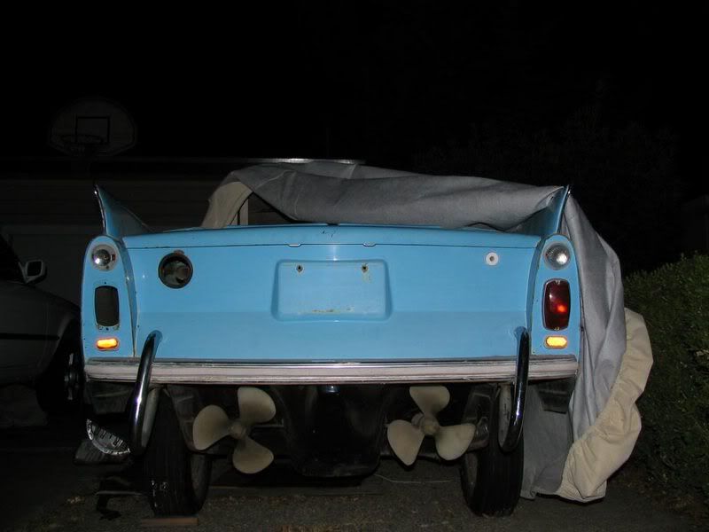

                  You wont believe what is under a car cover next to the driveway. Think out of the box. Next to the E30 there's a woody under the covers too, and thats cool/weird enough. I mean, there ya go, make a vehicle body out of wood! I couldnt imagine how they held up in crashes, spliters and shards of wood chunks everywhere couldnt have been healthy. This one gets the cake though, its not what cars are meant to do...........Leave it to 50's/60's thinking though to bring this to fruition.
                  It kinda looks like a boat...
                  ...um yeah.
                  It floats, or at least is supposed to. Just imagine how many seals there would have to be for the front end. At least the pint sized engine is in the rear.
                  Wild.

                    Holy crap. A boat car. Those are getting pretty damn hard to find.
