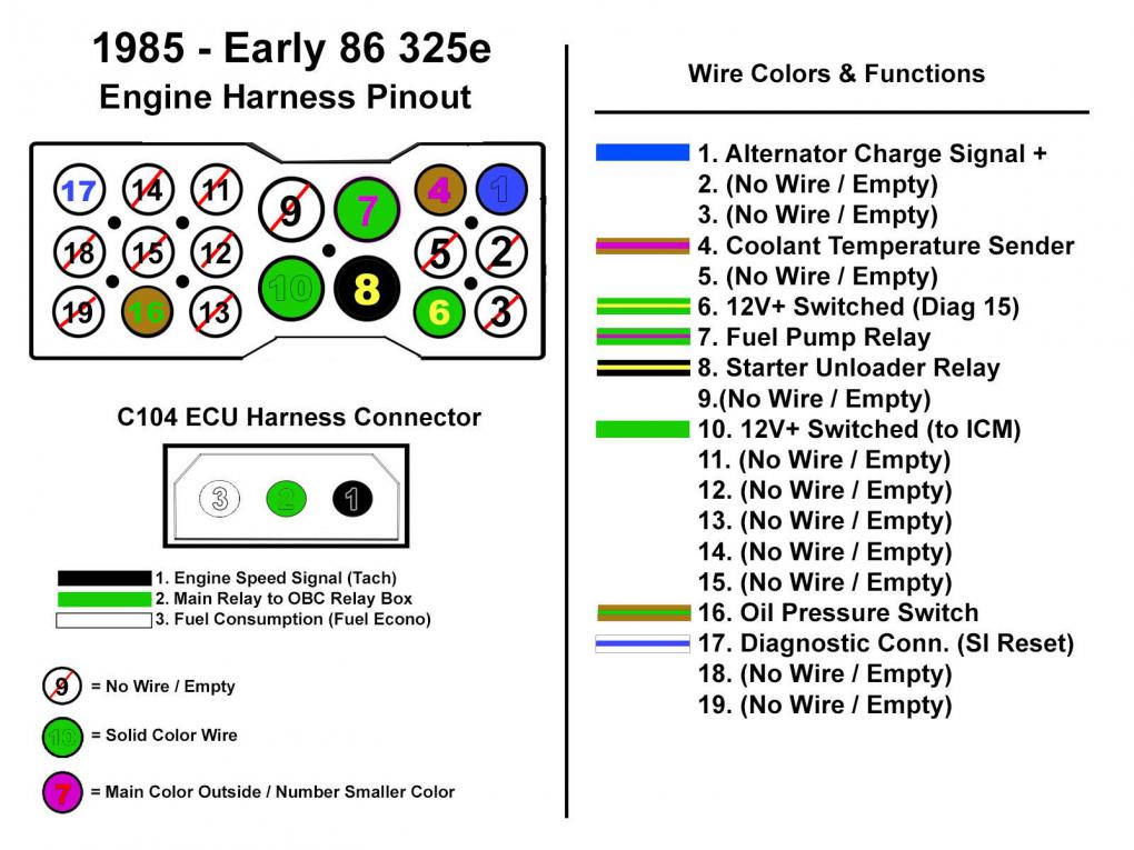

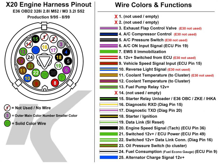

    X20 pinouts are different between M50 and M52
    Originally posted by priapism
    Originally posted by shameson
    • Northern
      I like cupcakes & sh!tboxes
      • 5246
      These should be the relevant pinouts if you're interested. Thanks to Kadunza for making these.

        Awesome. Thanks for the info!
