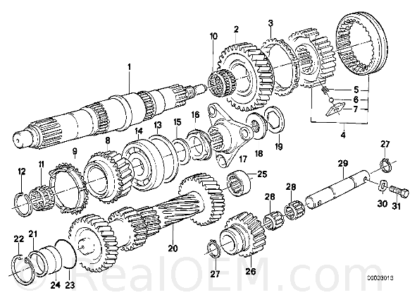

                    Neither......it is supposed to go on the front of the flange......the part that mates up against the inner race of the rear transmission bearing.
                    Maybe this will help. It goes on the very front edge of #17 (the edge facing the front of the car), and then that front edge gets mated up against the inner race of #14.
                    That should seal off the splines from the rest of the tranny. Of course if you are leaking from between the flange and seal.......then that is a different problem. I have so much oil getting thrown around, I have been having trouble figuring out where it is coming from.
