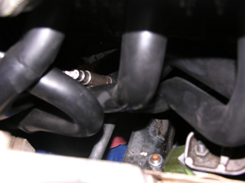

                    Originally posted by triggrhaapi
                    I wonder how it would work out if I stuck my O2 in the bung on one of my long tubes... haha. I'm expecting it to fire up soon as well.
                    What do you mean? It looks like you have the same headers as I do and I just put my O2 in one of the bungs that made it easiest to route the O2 wire.
                      I meant when I start the motor on open headers. I will use the midpipe crossover location for the O2 during normal use.
