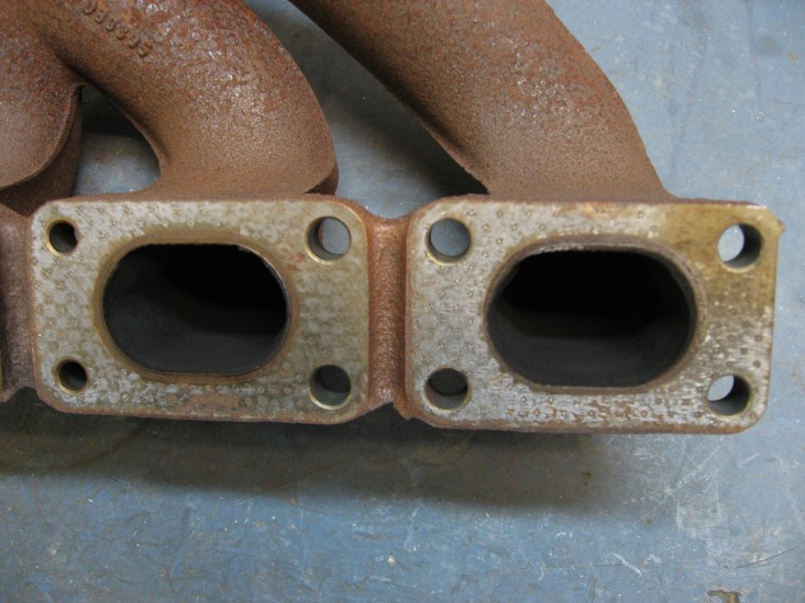

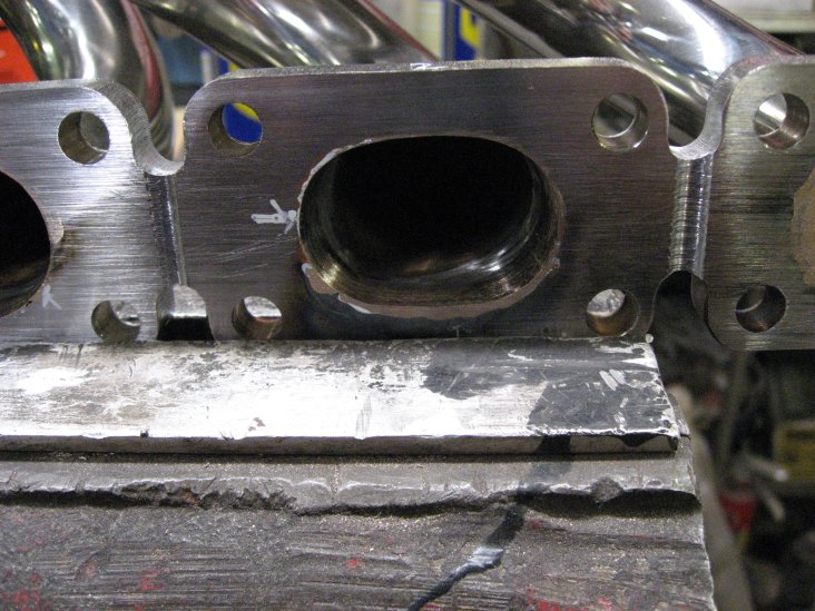

        If you plan on using BMW gaskets as I recommended, you'll need to clearence the flange between the ports. I did it on the milling machine but you could just use a die grinder.
        Look back at the earlier post and compare the flange to the one below.
        Hope this helps and have fun welding!

          ^ or you could cut the stock gaskets so that they are individual.

            Why do you need to cut them? The gasket is 4 times as thick as that little metal connection. The headers sit all the way down, and close all gaps. That little tab is just so that you can remove them from the head easier. It poses no problem, and none of the stock manifolds that I have are grooved like that.
                  You might be right that the thin wire will collapse - I never tried it.
                  I don't know what stock manifolds you have - I only have experience with stock s50 manifolds and as you can see, they do have reliefs cast into them so that the metal wire doesn't have to be crushed.
                  I think that just cutting the wire might be a viable solution if you can't/don't want to cut the flange.
