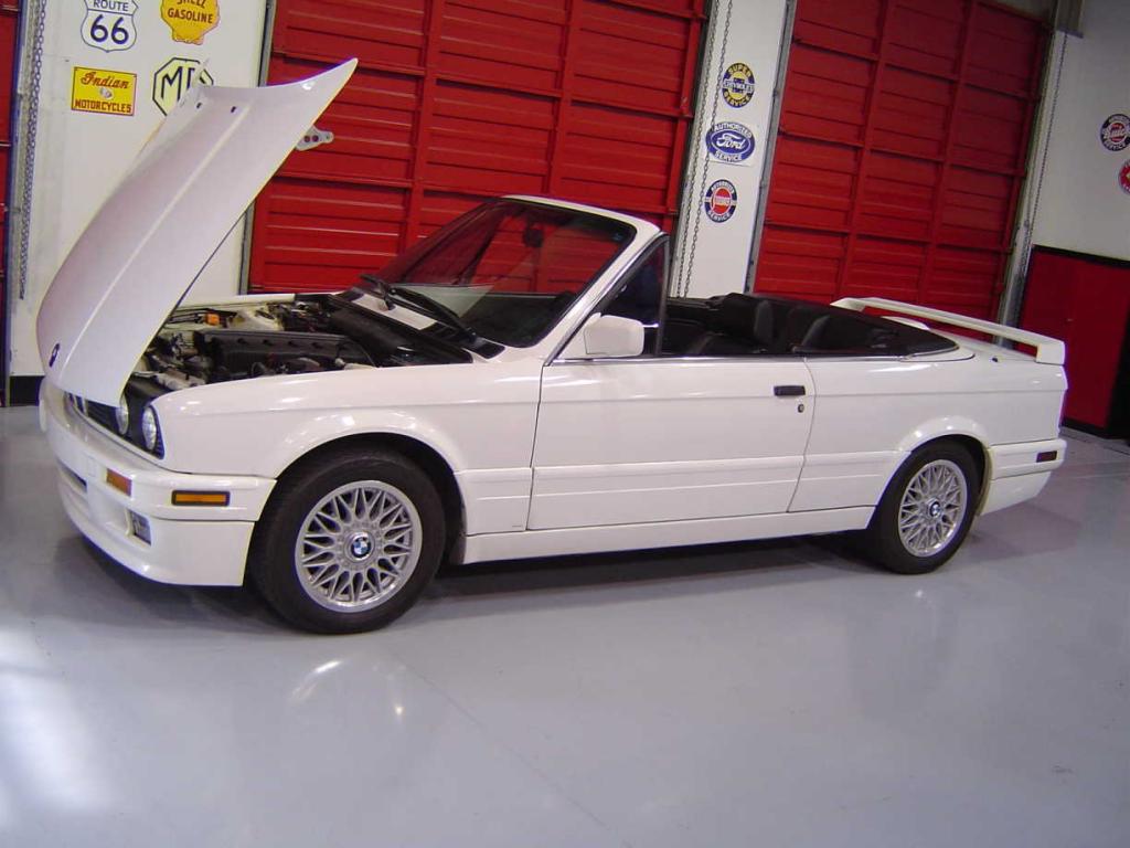

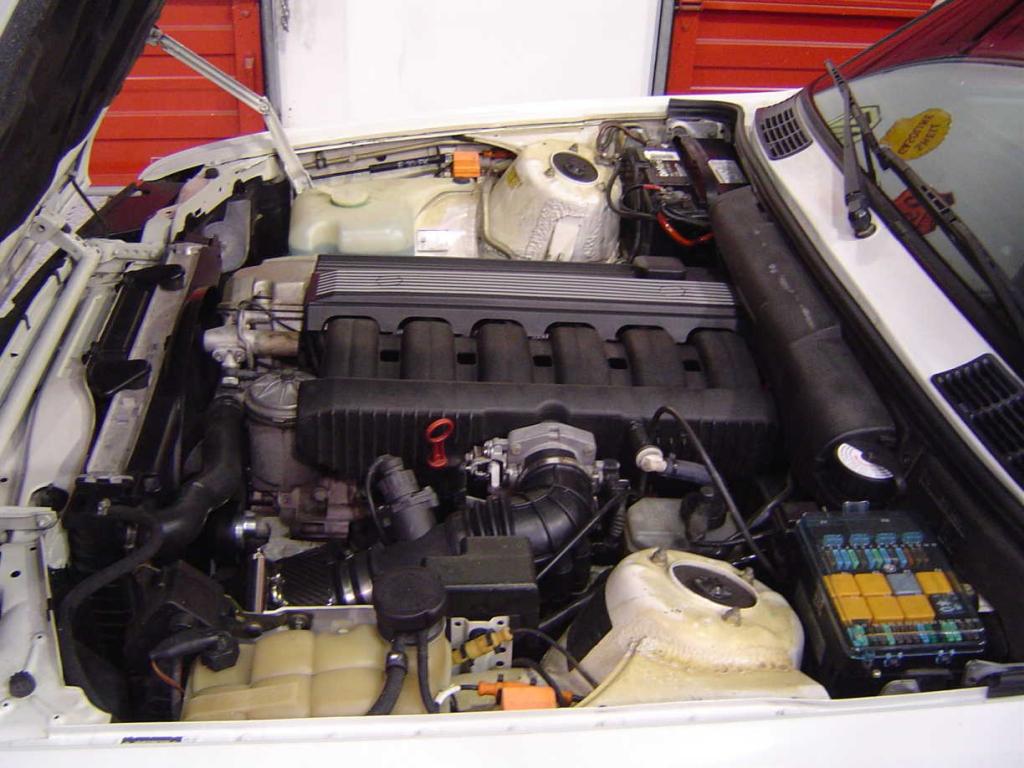

                          Nice looking cab! I see you went with the MAF at the 10 O'clock position... it really does make a difference.
                          I'll have the board out to you ASAP. The newest version is slightly nicer than the original with silk screened component graphics.
                          Hoveringuy
