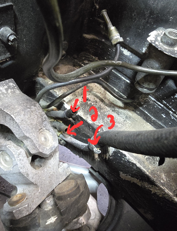

                          • Enriquez2000
                            • Apr 2024
                            • 152
                            I like pics to help others later on.
                            From this post it would appear
                            2 is feed
                            3 is return
                            I have to make soft lines up and havent crawled under the car but should all be same orientation right?
                            With that being said would the front part of fuel rail(radiator) and back be return(firewall). Every car Ive come across uses return as a regulator.
