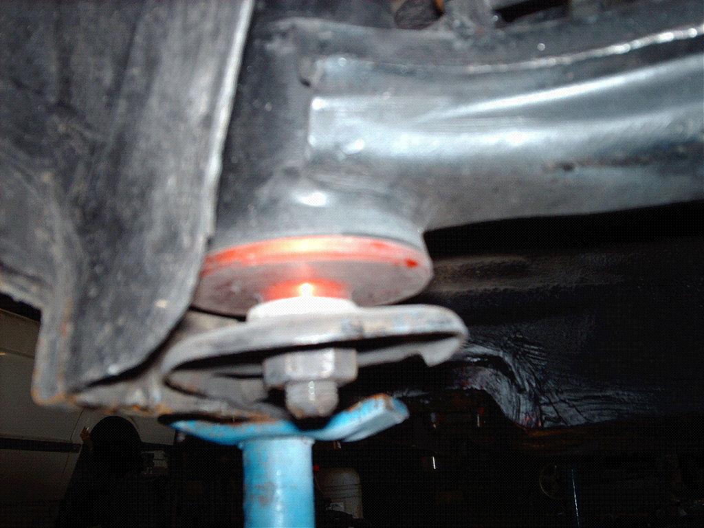

            Here is a picture (very fuzzy) of one installed. Notice the spacer at the bottom. 12mm doesn't seem like much, but it significantly helps the camber/toe. My car is on coil-overs and I gained around 1.75 to 2 degrees of camber back based on rough measurements. This improved handling significantly.

              Mike B. - do you need a modified bushing that will allow the subframe to sit up higher?
              • Mike B.
                • Jan 2006
                • 987
                Yep, the modified bushing is 12mm shorter, hence the need for spacers to properly locate the diff and bolt up to the subframe brackets.

                    Since the bushing is 12mm shorter than the stock bushing, you can use 12mm spacers for the diff bolts and the subframe brackets.
                    I found some M12 nuts from McMaster-Carr (12mm thick) and drilled out the centers to use as spacers.
                    I suppose a slotted or off-set diff bushing would work as well. You would still need the spacers for the subframe brackets.
                    Since I already had 2-pc poly bushings installed, I was just able to lower the whole subframe as a unit on a jack and pop the new aluminum ones in place. Compared to the task of replacing stock subframe and trailing arm bushing, it was really quite easy.
