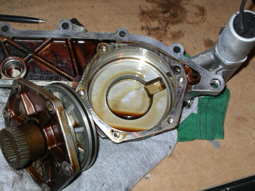

                        While I'm waiting for parts I've got mine laying around. Here is what it looks like broken apart... very simple.
                        It's a bi-stable hydraulic device. The solenoid controls pressure to one side of the disk or the other. Doesn't really matter how tight the seal is, excess oil leaks into the head.

                          It does matter how tight the seal is as it won't advance the cam if there is no pressure.

                            There's hardly anything to rebuild! Do they replace the large O-ring?
                            The biggest way I could see improving the VANOS unit would be to change the way the shaft fits through the cover. It's a loose fit and I can see how it could rattle. Put a stainless sleave in the cover and then an O ring to keep the shaft from rattling.
                            I could see that.
