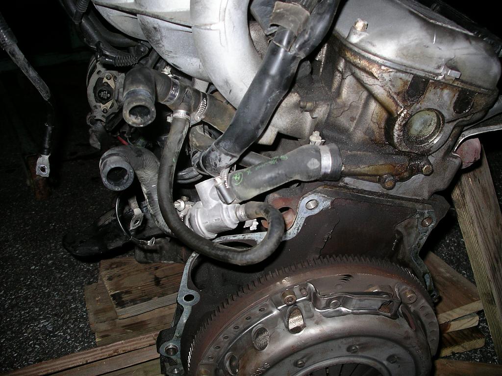

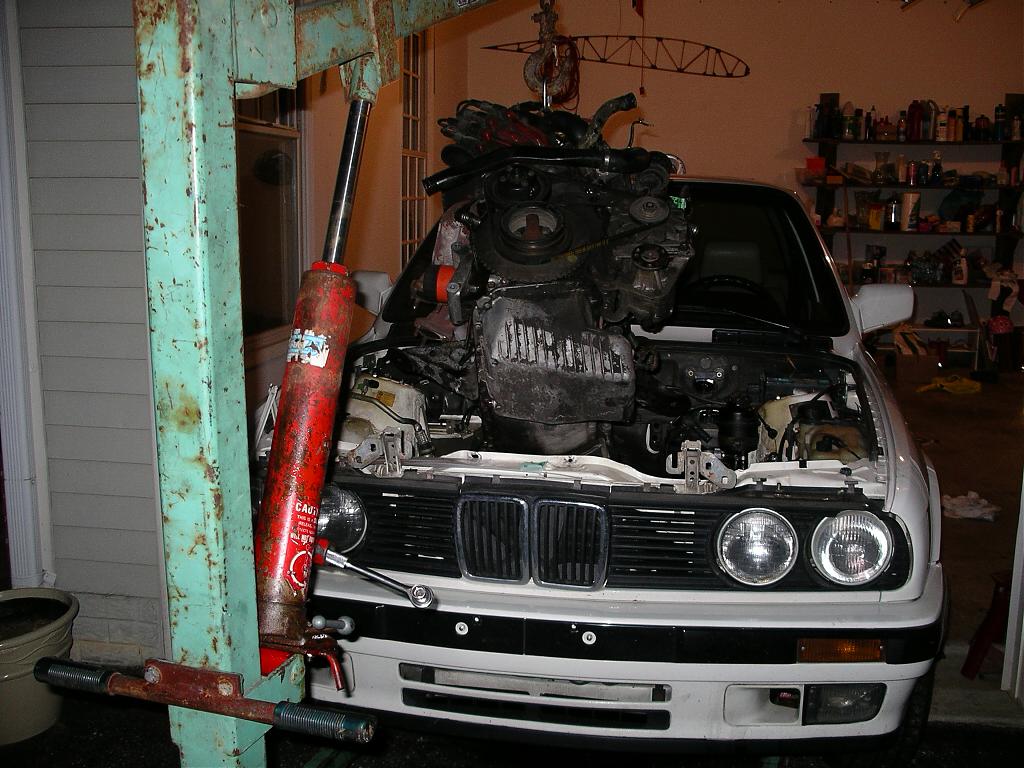

    So I started tonight, took me about 4 hours to pull the motor in the cold. No big suprises, except the tranny mounts were torn. Used the patented front-hook-only removal, no sweat (really, because I was freezing!)
    The only weird thing I can't figure out is my hoses to the heater core. WTF? Anybody ever seen a bypass hose? Is that stock or a special Arizona mod?
    Do I need to order another hose for the M50 connection to the bottom heater core pipe??

    Nah, that was a recall item, after heater cores occasionally blew up, spewing hot coolant over people's legs.
    That valve reduces the likelihood of it happening.

      So do I keep the bypass or order a straight hose?
      Also, on RealOEM is that the "water hose inlet" or "water hose outlet" coming out of the back of the head?

        straight hose and make your own with heater hose.

          I went to the dealer and got the proper hose, hope my heater core doesn't pop on me now!

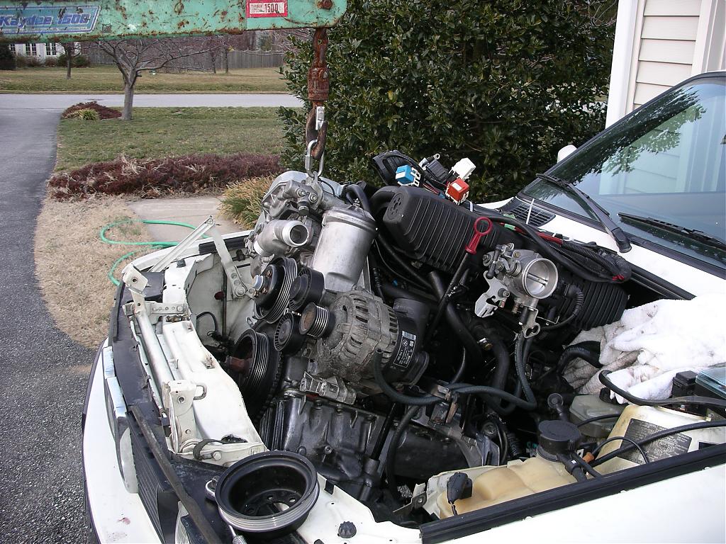

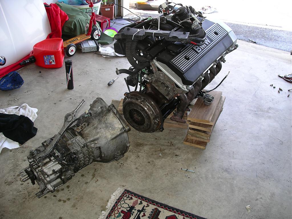

          Swapping the tranny went smoother than I expected. Popped the old idle bearing and replaced it and the throwout bearing. Clutch still looked fine so a machined, lightened flywheel went on and then the tranny. No clearance issues but I left the bottom bolts out because of the alignment.
          Motor went in soon after and installing took about an hour. I hung it off the front mount again and jacked the front of the car up after the motor was dangling over the engine bay. After that it was a combination of lowering the motor and jacking the transmission to get it in. Perfect fit!
          There's 1/16" clearance at the brake booster so I may shim the drivers side later but no worries for now. How much clearance should I have (320 booster)

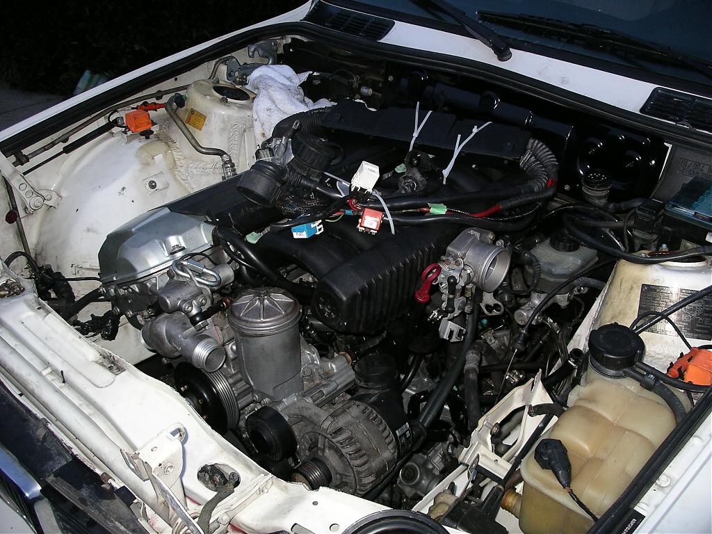

          After I connected basic electrical and fuel I made some cursory electrical safety checks (does ignition on make smoke?) cranked it and it started after a few seconds. It fell into a very loud but smooth idle.
          I'll install accessories and start on the exhaust today. The center bearing was shot so that's on my list, too.
          ...and it's just not a swap without the "in the engine bay" picture... <grin>
