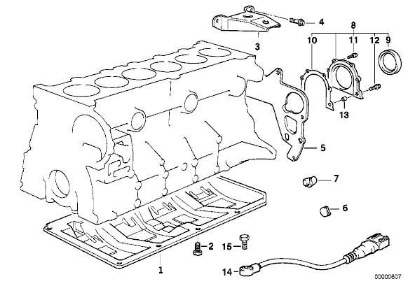

                          hey guys I am doing an M50 into my E30 while using the Getrag 260, and was wondering if this part is necessary. It seems to be a covering plate between the rear of the engine and the transmission.
                          It is number 5 on the realoem diagram. P/N 11141734019. Thanks guys! I'm a noob!
                          • bimerok
                            • Apr 2007
                            • 149
                            #868
                            This is a protective cover that covers up flywheel. You can run your engine without it, but it is a very good idea to have it on. It protects the clutch from dirt, water and body parts from getting there while engine is running.
