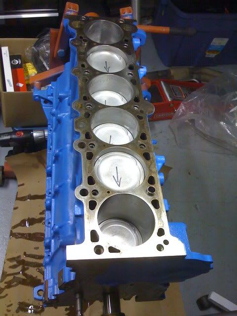

                Short update:
                Finished putting the bottom end together!
                (crappy phone pic)
                Couple of tips: Make sure the ring compressor is sitting fully flat on the block before you smack the piston down. I had trouble with 2 of the pistons because of this.
                Also, make sure the piston is rotated correctly, else the con-rod will hit the counter-weights on the crank when trying to push the piston down. Everything will stop and the bearing shell will fall out!
                Now i need to install the cams on the head, and the head onto the block. Then I get to install the timing chains and oil pan.
