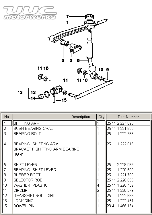

                  Originally posted by beirbrennere30 View Post
                  i get asked pretty frequently how i fit the getrag s6s-420g transmission from the e46 m3 into my e30. So instead of answering the question a few times a week i thought i would just do a write up of the parts necessary and some tips and notes.
                  Parts:
                  E46 m3 getrag s6s-420g transmission
                  e46 m3 flywheel
                  e46 m3 clutch
                  e36 325i clutch slave cylinder(there may be a better option out there but i know this works, the pedal is kinda light for my taste)
                  custom trans x-member
                  automatic e36 m3 with e30 csb driveshaft
                  e46 m3 guibo
                  e36 engine to trans mounting hardware(e46 stuff is too long)
                  e46 m3 driveshaft to trans hardware (12mm bolts)
                  e36 m3evo shifter assembly(details below)
                  e30 late model rear shifter mount
                  shift knob with 6-speed shift pattern ;)
                  install highlights:
                  The e30 reverse light switch threads into the e46 trans no problem and functions
                  you need a lower rear end gear ratio. I run a 3.91 and its very streetable. For a daily driver the 3.73 would probably be perfect.
                  For the shifter you need the e36 m3evo 6-speed parts:
                  thats everything in the above pic except 12,13,14,15. You need 1-11! This will slide into the late modle e30 rear shifter support. For early e30s(pre '86) you need to convert to the later style mount.
